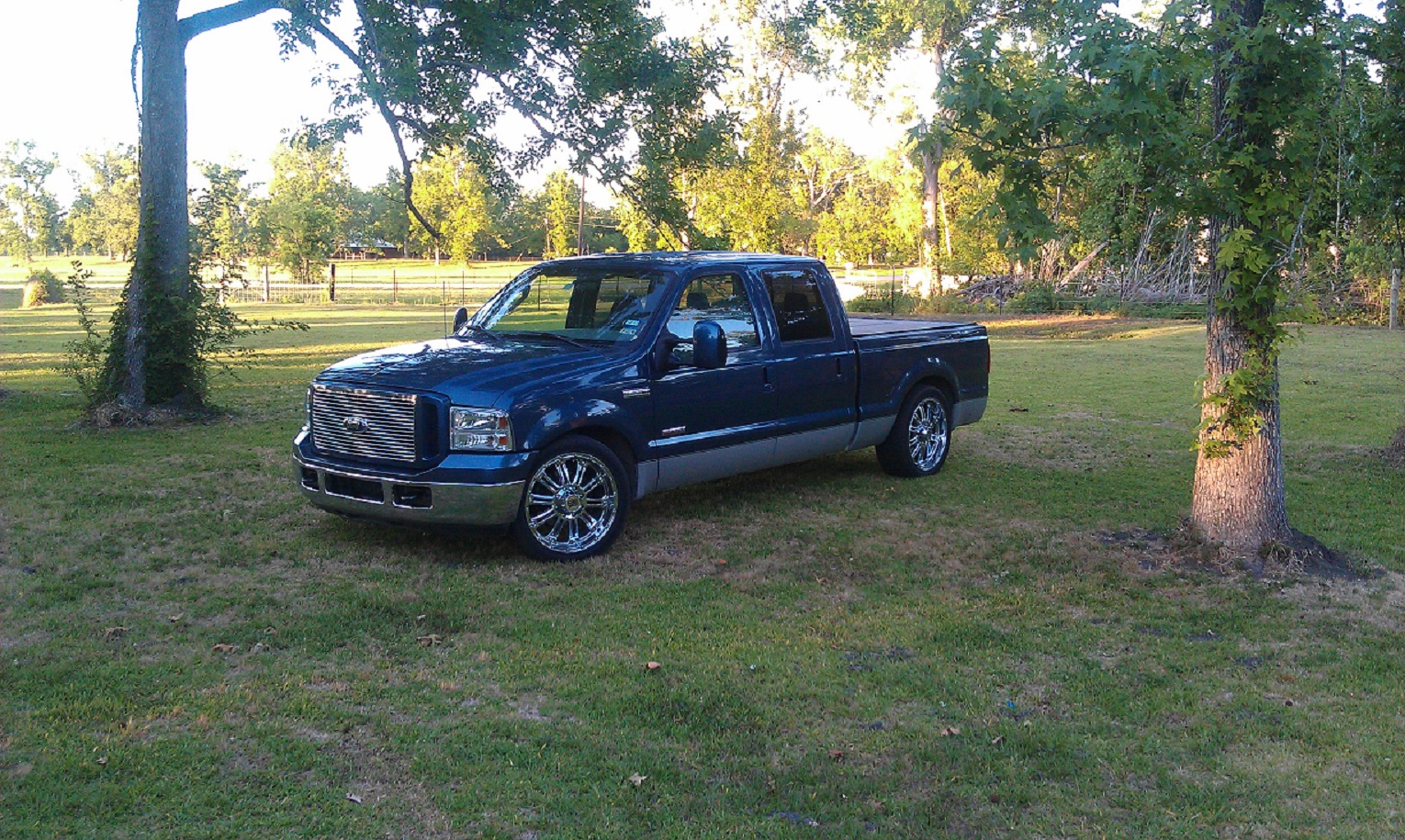

My truck with the 3"/5" drop
For the record you can not fit a 5" drop and a 5" exhaust

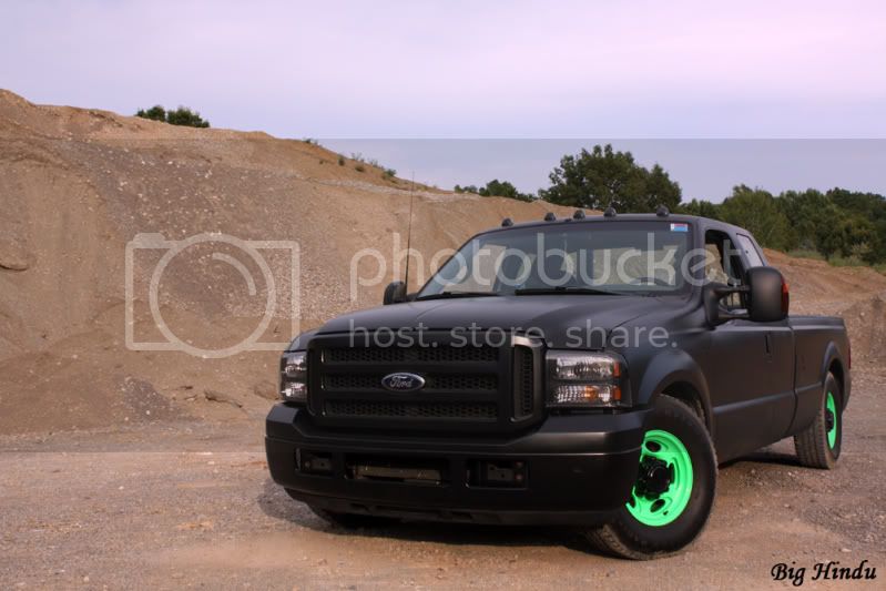

My truck with djm 3/5 drop
Sorry pic didn't post last time
