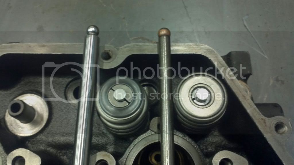

I sent my heads to Doug at GoGo Diesel to get some work done to them and he has been working on some new parts for the 7.3 world. Here they are.

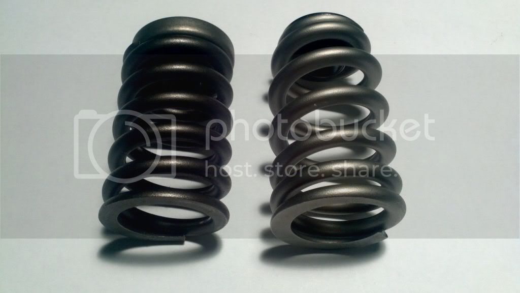

Stock is on left and the new ones are on the right.
Stock seat pressure is 72lbs and the new ones raise it to 175lbs
FWIW, comp 910s are 92lbs
Stock on left new on right installed in heads

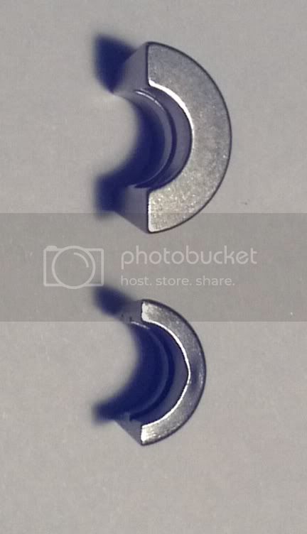

Stock is on the right and the new ones are the left. These are the locks that keep the valve springs on the valve stem.
Stock on right new on left.
stock is 11/32'' New one are 7/16'' (aka Louisiville Sluggers)
FWIW most aftermarket ones are 3/8''
Enjoy and if anyone is interested in some get up with PTP and they can get you hooked up.
