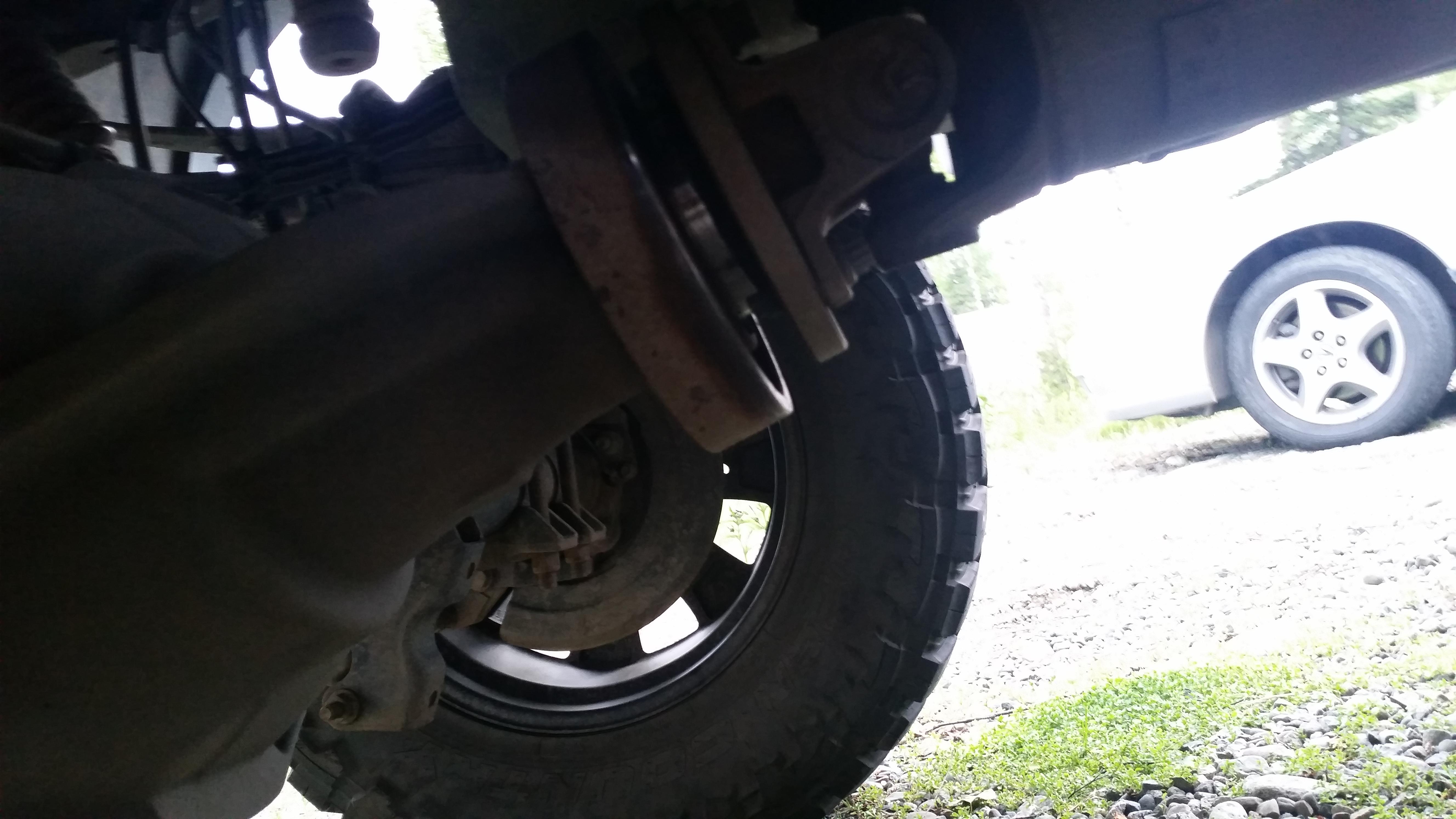

Rear damper broke. If no movement n bearing up and dwn/side to side: remove four 12mm 12 pt on flange to yoke: separate . Count threads on rear pinion: remove nut (easiest w an impact). Not sure how it comes new but at that point with new balancer in hand (as long as serviceable item) u should be able to look at ur new part and see how it works. May not be a bad idea to put a pinion seal in it as we'll. parts should come apart and pinion cannot go anywhere so a couple screwdrivers and usually able to pop it out. Do this all with wheels on the ground and chalked. If u can't figure it out I can send u all data instructions. Never doneone of those in particular but seen it many times
