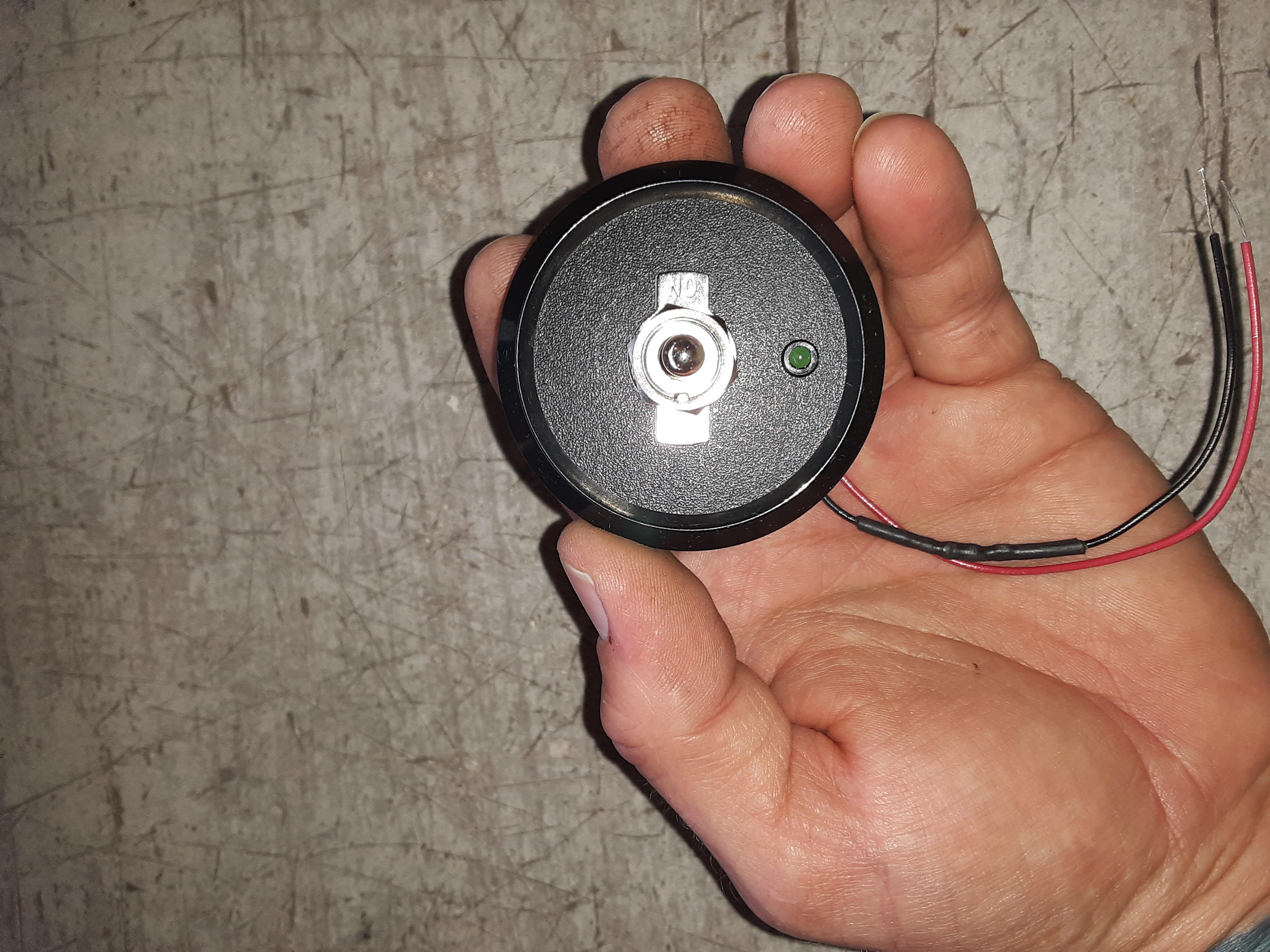

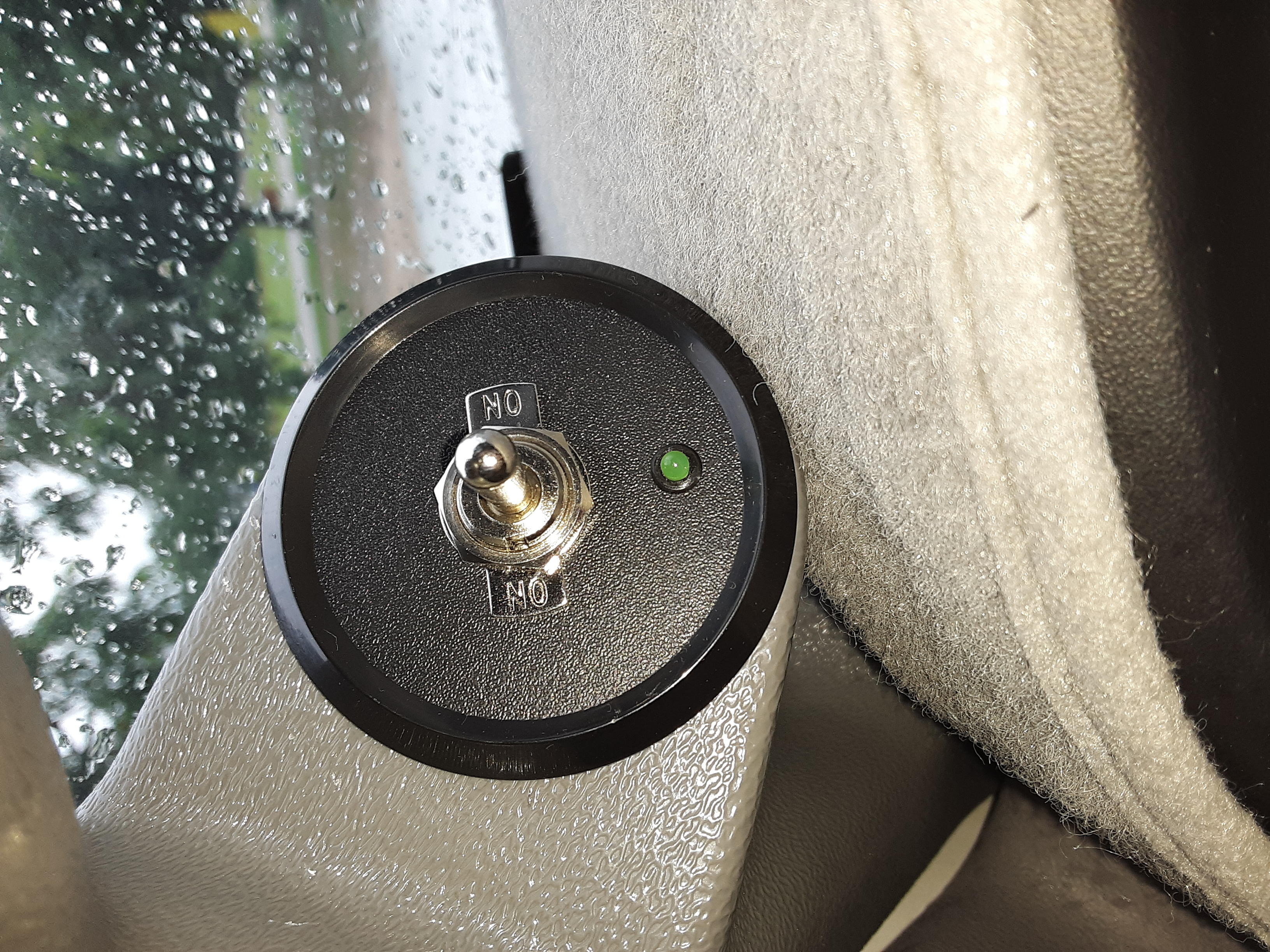

So here's me thoughts I can see a possible problem with the fuel pressure activation. It could cause the pump to cycle on and off fast right if it picks the pressure up fast . Then it would kick off then pressure could drop fast then cause it to kick back on . Could this this cause a problem?

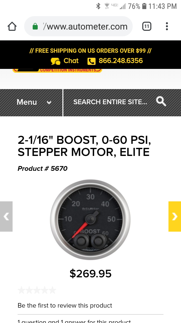

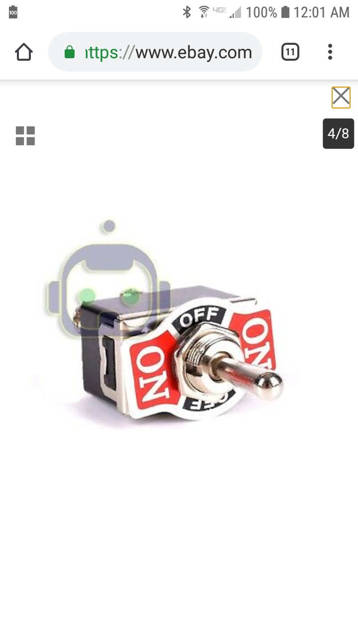

So I'm lean more to the boost activation using the autometer elite gauge as the in cab adjustabilit would be great plus running it through a on off on toggle switch so I could run the pump from the gauge or have completely off or run through keyed power as a manual on if I just needed even in a primary pump failure. Thoughts ?

Nothing wrong with a manual over ride switch. You can go the route of boost activation for the second pump. I do see one issue with that. You can have high fuel demand with low boost. Such as the moments you mash the pedal down and the turbo is not spooled up yet. I personally would tie the second pump on demand to the throttle pedal. Simple to do. Build a bracket and mount a lever style limit switch. You can adjust it so the second pump is activated once the pedal is pushed down far enough. Say for example 60 or 70% throttle. You can even use MFD on a scanner to fine tune switch position.

Well I ordered the boost gauge yesterday and got a one off on switch. So we will see . Maybe there want be a low pressure before boost . Is so I will go to pedal switch . Some say the one pump will handle 238/80 fine . So at that maybe at boost will it ever need the secondary. And I will have the manual over ride in the switch.

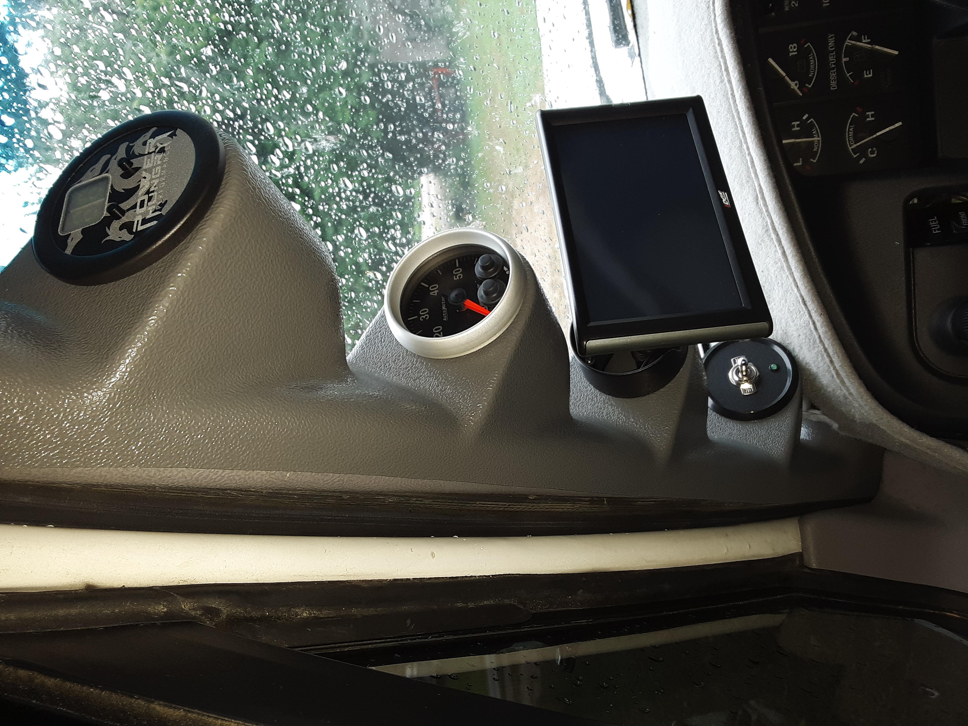

Well here it is all mounted up . Got to wire the boost gauge and switch and install the hydra for the selector to work . 20190729_133745.jpg
