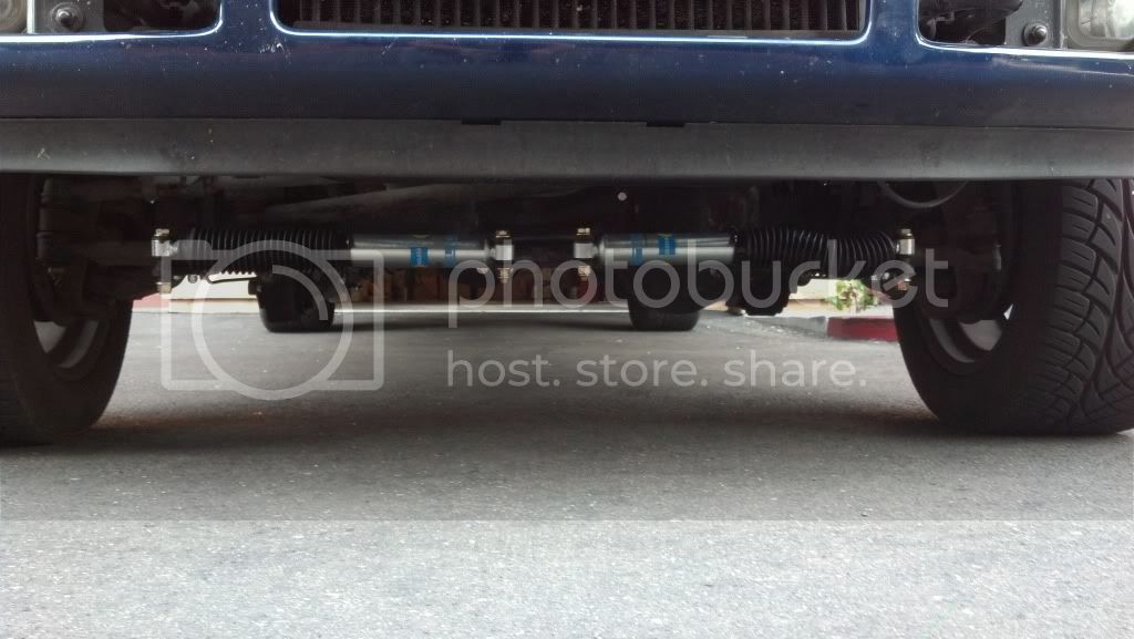

Im pretty sure they will as the stabilizer mount flush with the top of the center drag link when mounted under the bracket. If one of you guys wanted to try a kit, I would be willing to cover return shipping with no restocking fee if it didnt work out. You would have to install the kit and cycle the suspension in your driveway so that nothing was damaged but I would take the kit back if you determined it wouldnt work.
So I picked one up for my truck which is lowered and it does hit but only on quick up movements. With some minor clearencing of the engine cradle it should work. I did speak with Trevor and he offered to take the kit back and I thank him for that. There also seemed to be plenty of space for the track bar, but I will confirm that after trimming. Thanks again Trevor.

I mounted mine under the bracket, Fits fine! Did have a few hardware problems, but its been on the truck for about 10K miles and has been working great!!!
