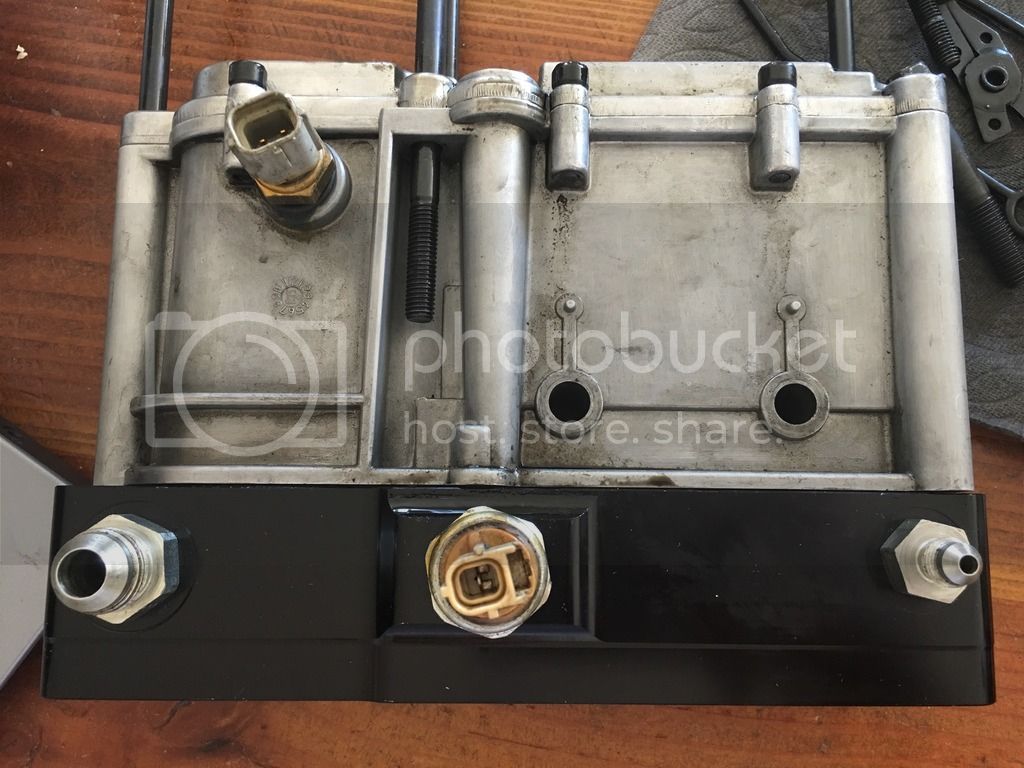

lol... I really doubt I left anything in a port, I just don't want to rule it out. I think I have the plumbing to the HPOP spacer wrong. I think the IPR dump should be in the center port and the oil pressure sensor on the right.

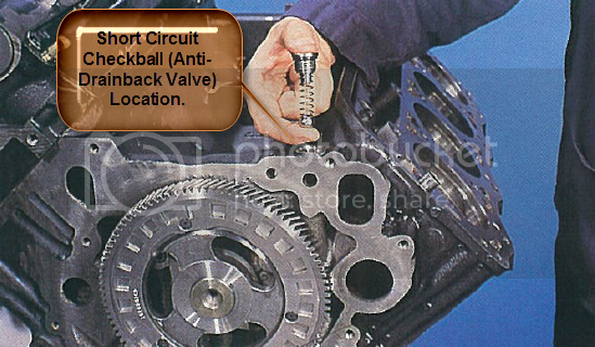

You could take the short circuit plug out and make sure oil is going through it.
VegasFMF
Apr 30, 2015
29
Las Vegas
I just pulled the plug, got the spring out. I'm still trying to get the ball out. What should I do after I get it out? If there is something lodged in there I want to be able to get it out.

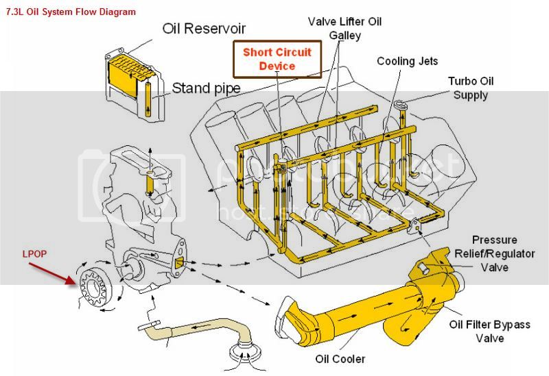

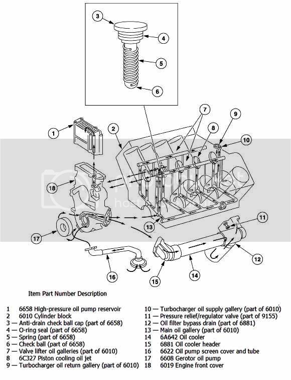

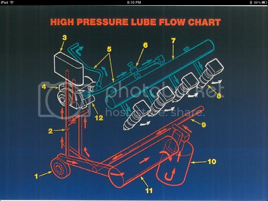

Looking at this flow chart the short circuit valve looks like its the culprit. Number 2 is the value
Magnum PD
9,566
8
VA
Once you get the ball out, crank it over and see if oil comes out.

Put it back together without that spacer and see how it runs.
IIRC above that temp sensor in the top cover is where I had my IPR dump so it’s possible you have them switched
uncool
Jul 22, 2011
273
California
Who's spacer is that?
Put the pressure sensor back in the top where it goes.
The center port should be in line with the factory IPR dump port. The right port should be just an extra hole that dumps to open space.
