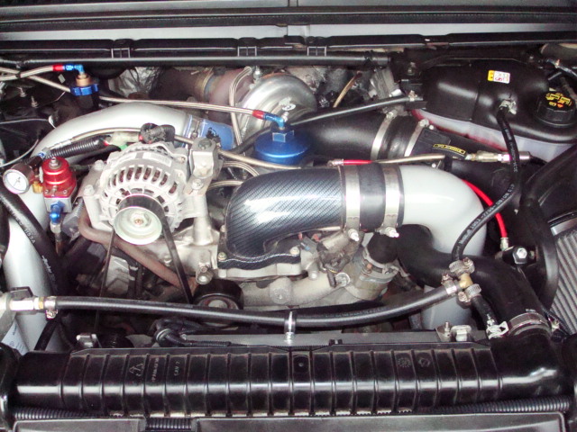

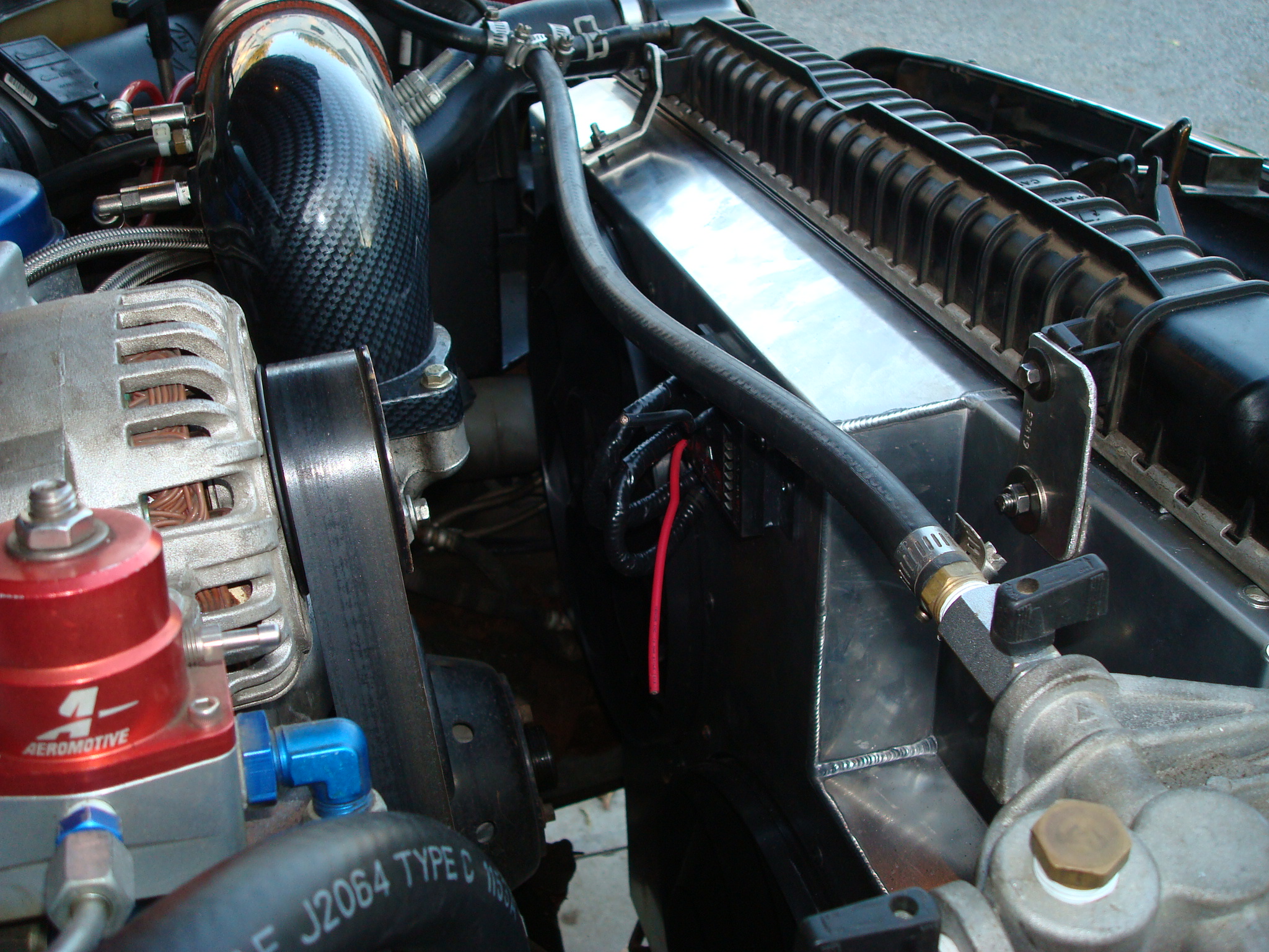

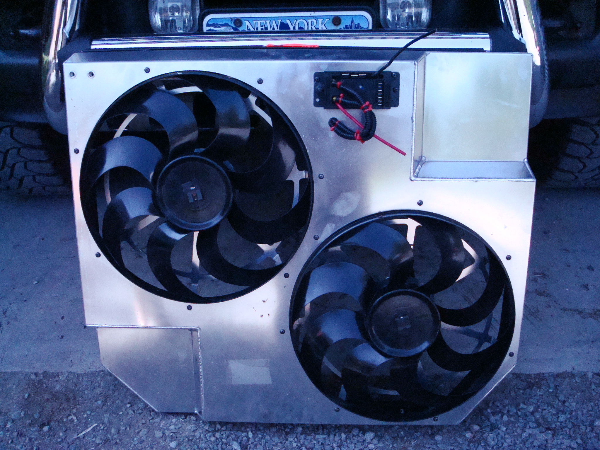

Yes. I've been running the flex-a-lite electric fan kit on my truck for almost 2 years now with zero issues. Makes for tons of room under the hood. Flex-a-lite doesn't have one exactly for the 6L, but the one for the 7.3 fits with just a little modification.
strokin6L
2,979
Springville NY
Here's mine installed

Thanks for the pictures. I really think this could free up some horsepower. How did you get the fans to work? I mean did you tie them into the stock thermostat or add one?
strokin6L
2,979
Springville NY
No....there is a VSC(variable speed controller) bolted to the fan shroud. You just need to run a wire from the controller to a 12v key on source, one wire to + terminal on battery(which has a 50amp circuit breaker) and one wire to - terminal on battey. Then there is a temperature probe that goes into the fins of the radiator and is wired to the controller also. However it says in the directions to also wire the controller into the A/C so that when you turn the A/C on that the fans will come on with the A/C. But i didn't do that and i know of others that didn't do that.
