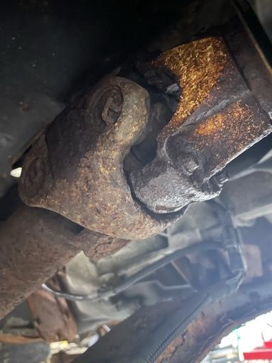

Got the front and rear disconnected but the double cardon joint looks like a major pain in the azz
I will leave it in place for now when I pull it but I would like to replace those U joints
Rusted 8mm/12 point
F to the U
Plasma cutter standing by.
