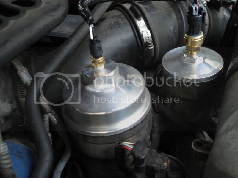

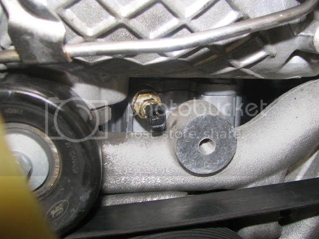

Semi-hijack to this thread - where are people installing add-on EOT sensors? I know on 7.3L we could just put a sensor in place of the port in the top of the HPOP reservoir, is there any easy location like that on a 6.0L?
Thanks,
Michael Pliska
As far as I understand there are 2 options on the 6.0L
First, what I have, and what I believe most have, is an aftermarket billet oil filter cap that is pre-tapped for the sensor,
Second, the factory test port on the front cover/oil cooler, little harder to get to,
