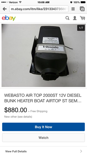

Then get the air top webasto heater and install it in the cab. It works really well I have installed lots of these gems for oil field trucks. ImageUploadedByTapatalk1417280951.942886.jpg

Espar makes the D2 airtronics unit that does just that. It's fuel only. You mount it in the cab an it just heats the air. Work great. I do have to work on them quite a bit but that's only because of naive truck drivers that don't use them for months on end an the glow pin filter plugs up . But other than that they are good heaters
