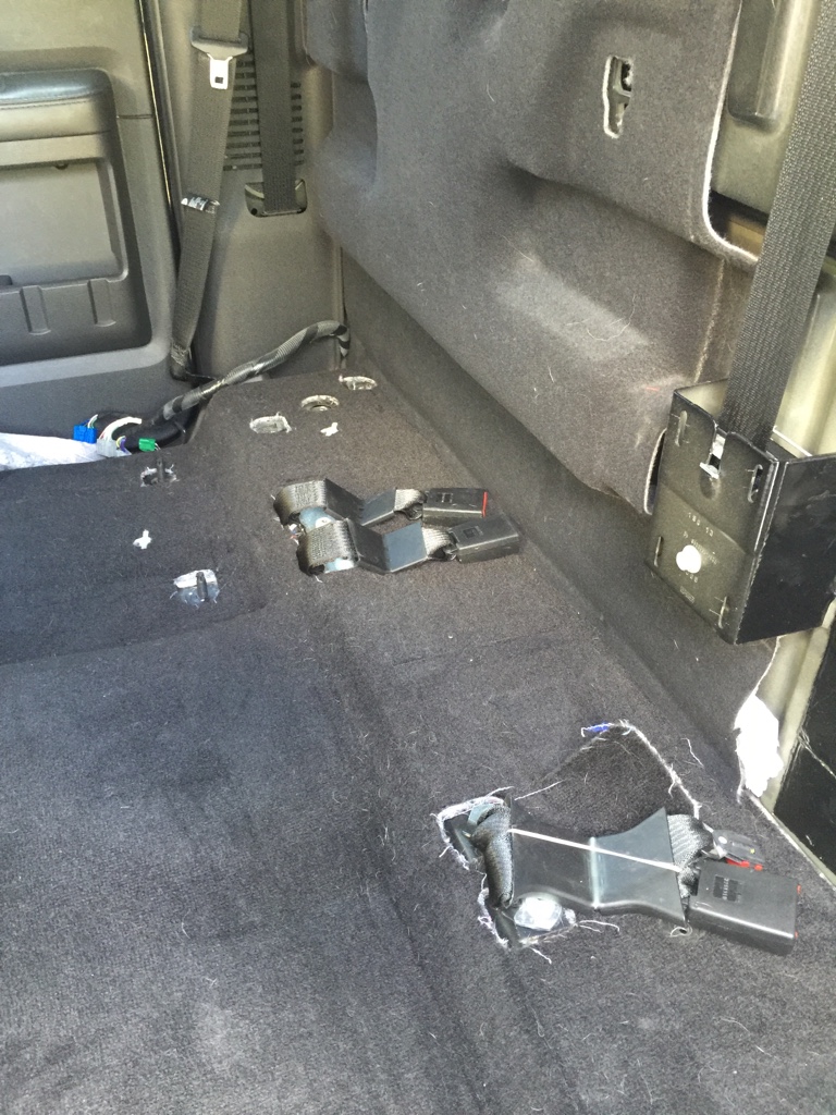

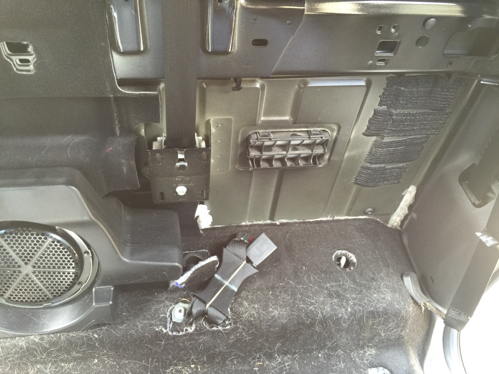

First start by removing the back seat...
**please excuse the dog hair, that was a surprise left from the previous owner lol...

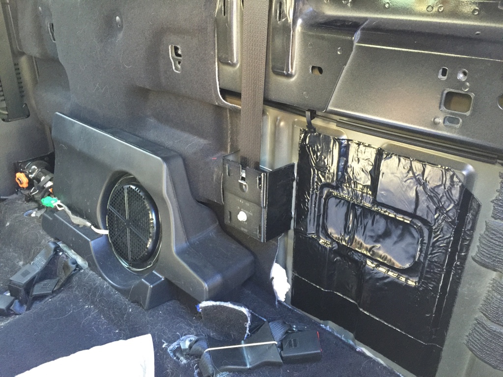

Next you will need to pull this vent out because the box won't fit it you leave it in.

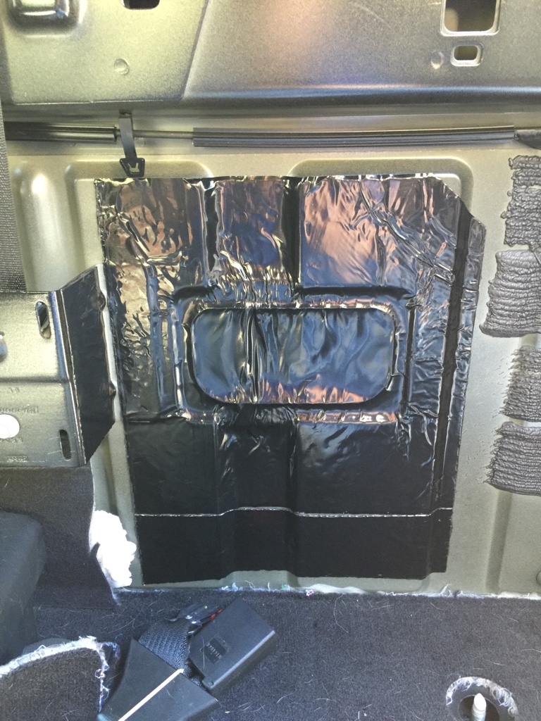

Cover the vent and surrounding area with hush mat

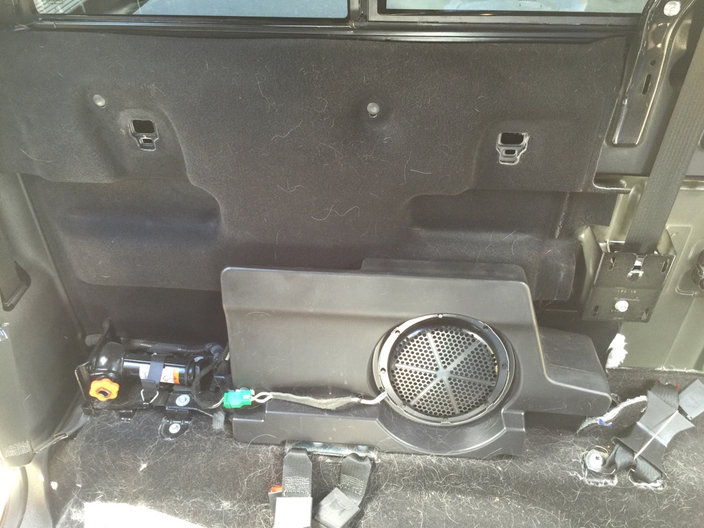

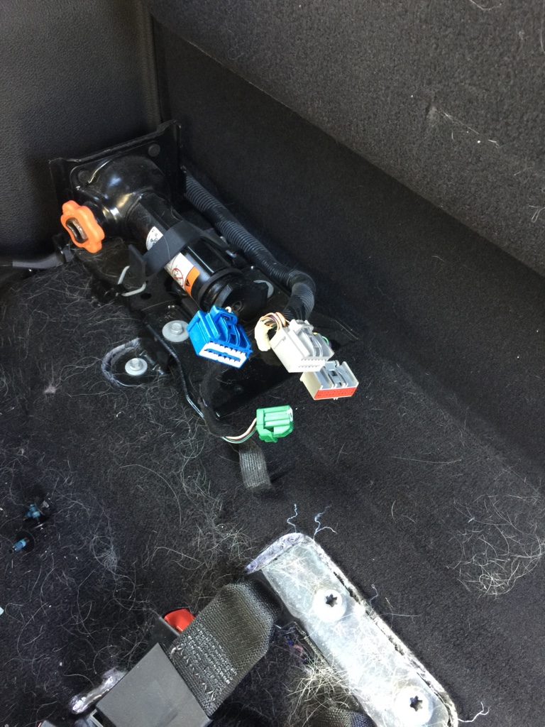

So now it is time to get rid of all of the factory sub equipment and tire jack.
Once that is removed, you will need to take the factory Sony amp off of the subwoofer box and find a new home for it to be mounted. I just stuck it on the back wall.

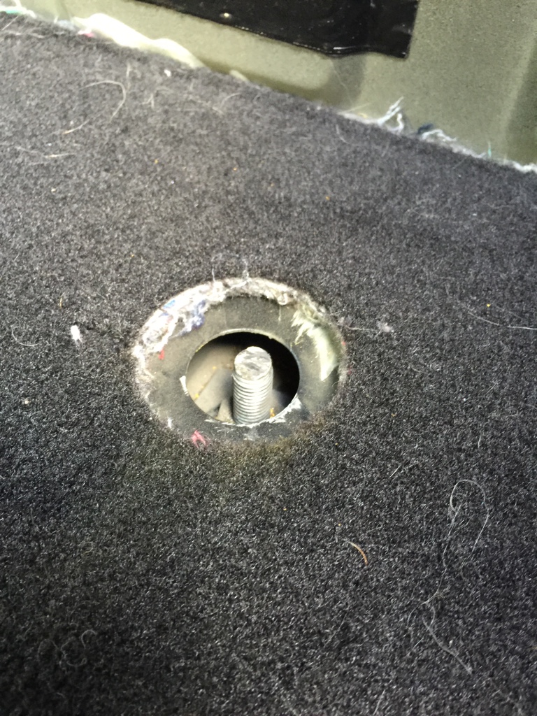

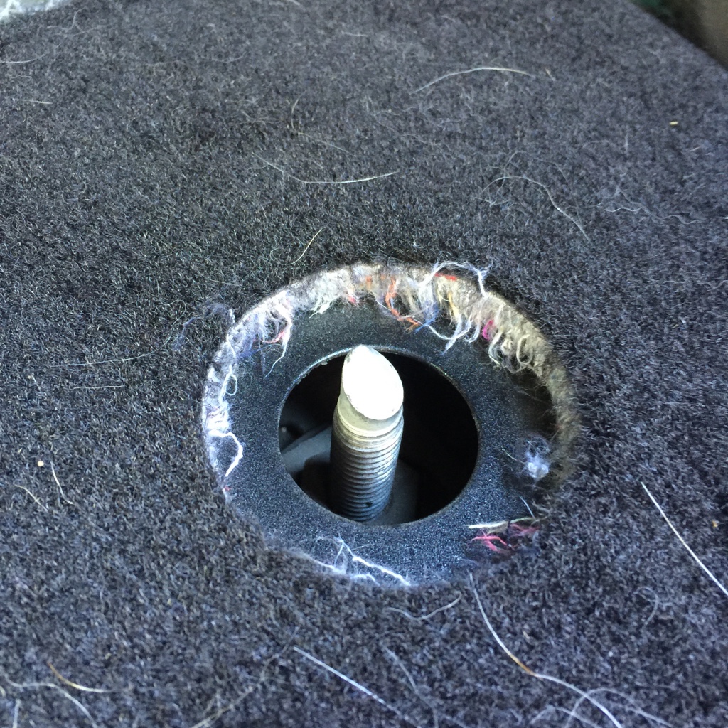

I don't know how crucial this is, but I didn't want the pointed cab bolt to make my box sit unlevel so I dremeled the tip off...

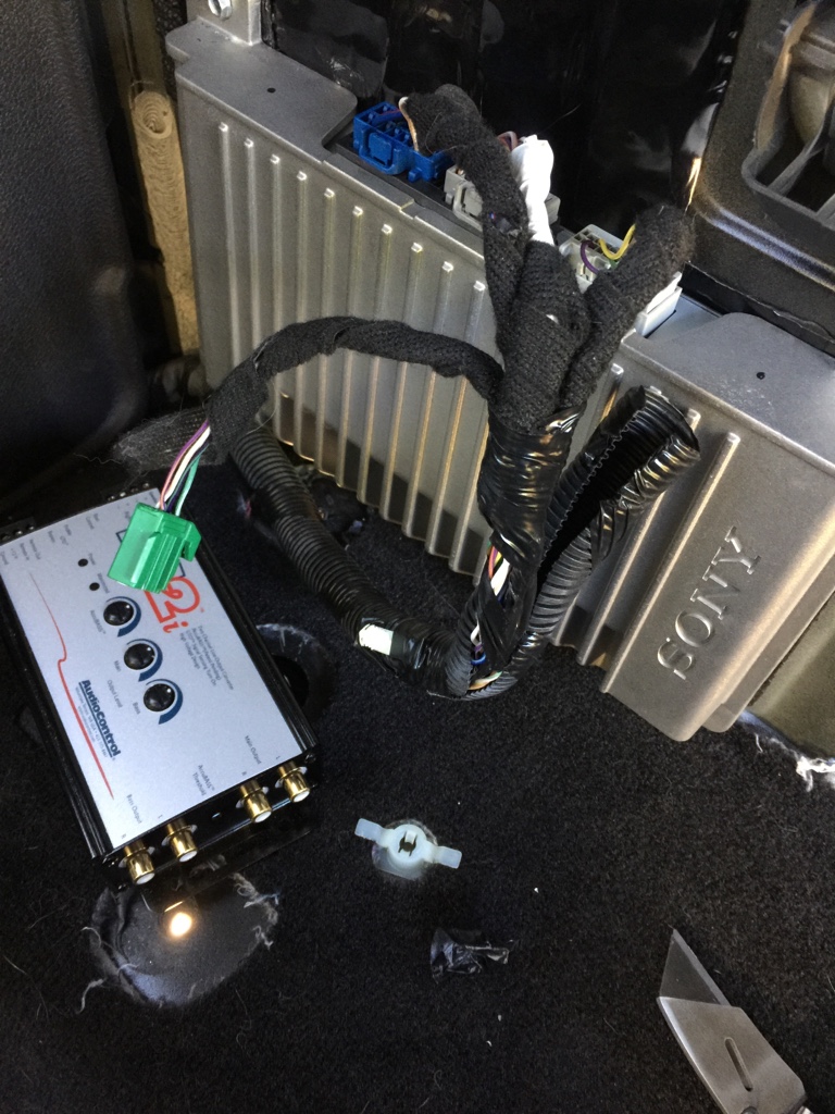

So. Now a quick clean-up to get rid of that doggie fur and dremel debris.

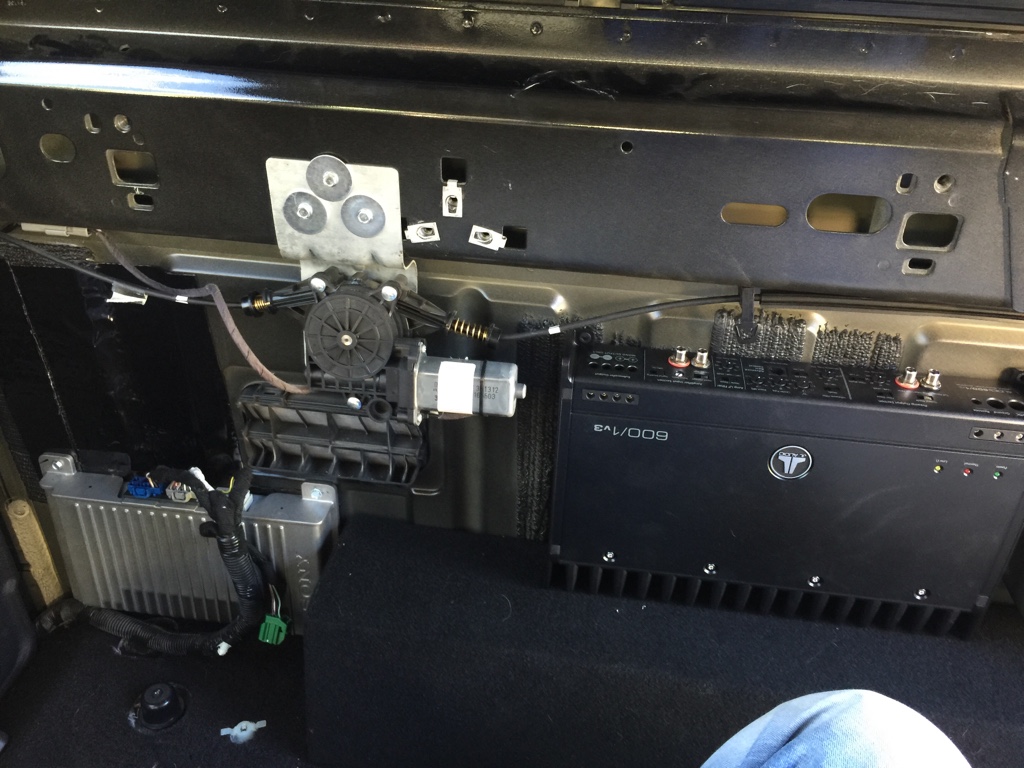

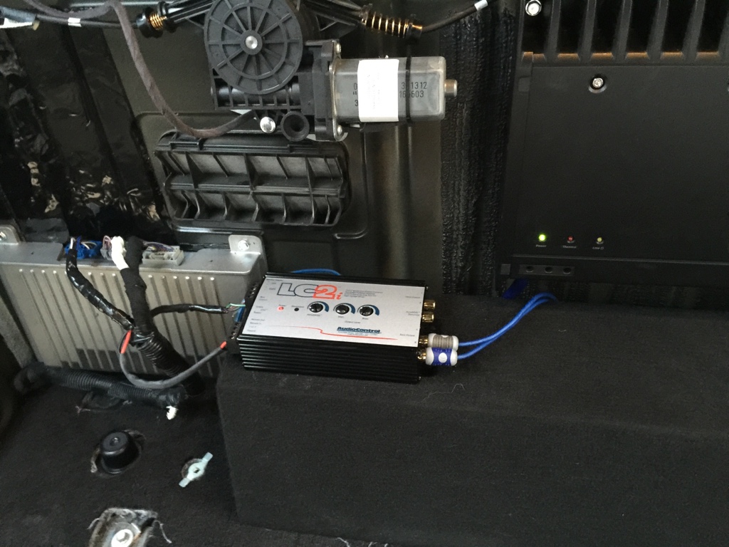

Now we can test fit the box and look to see how things can be mounted. (Quick note: I ditched the entire carpet lining that goes on the back wall. It was too much of a hassle to try and make fit back right, plus I didn't want it to overheat the amp).

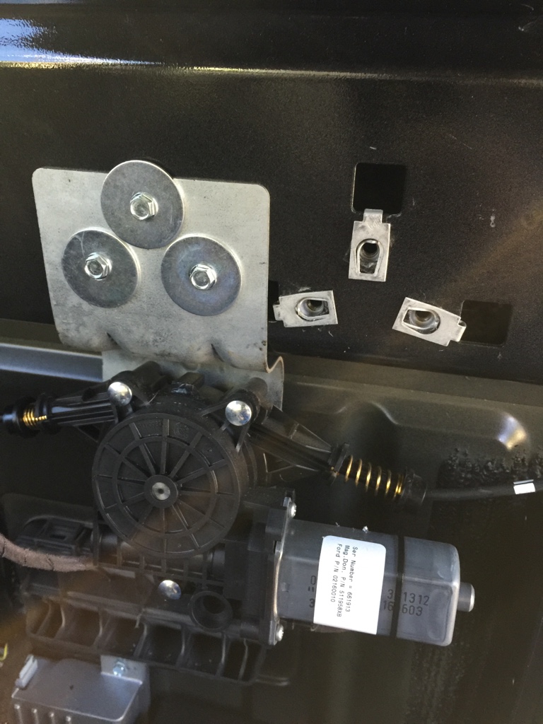

Using the amp I did, and the location I did, I had to shift my window motor over a little bit...

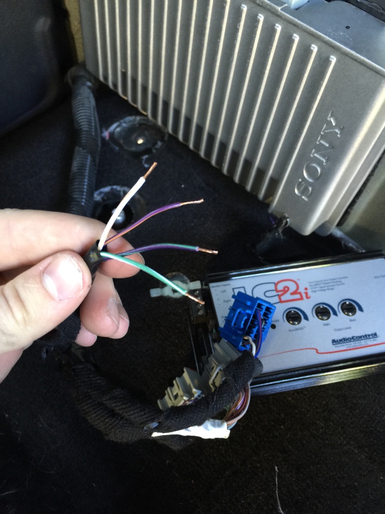

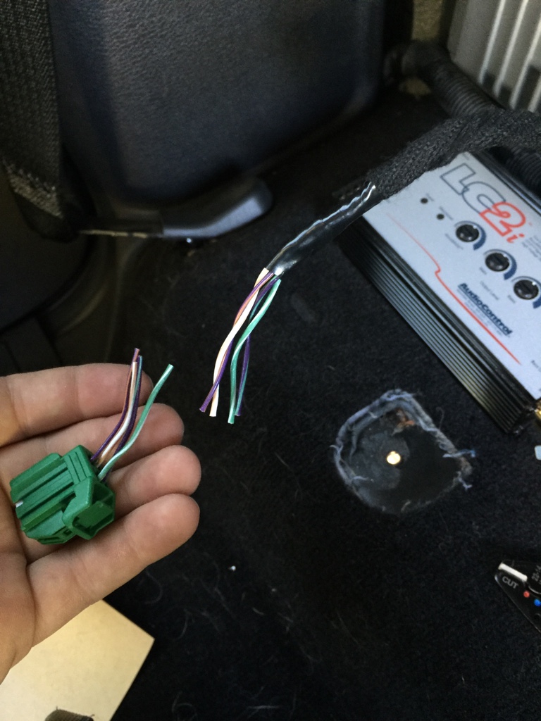

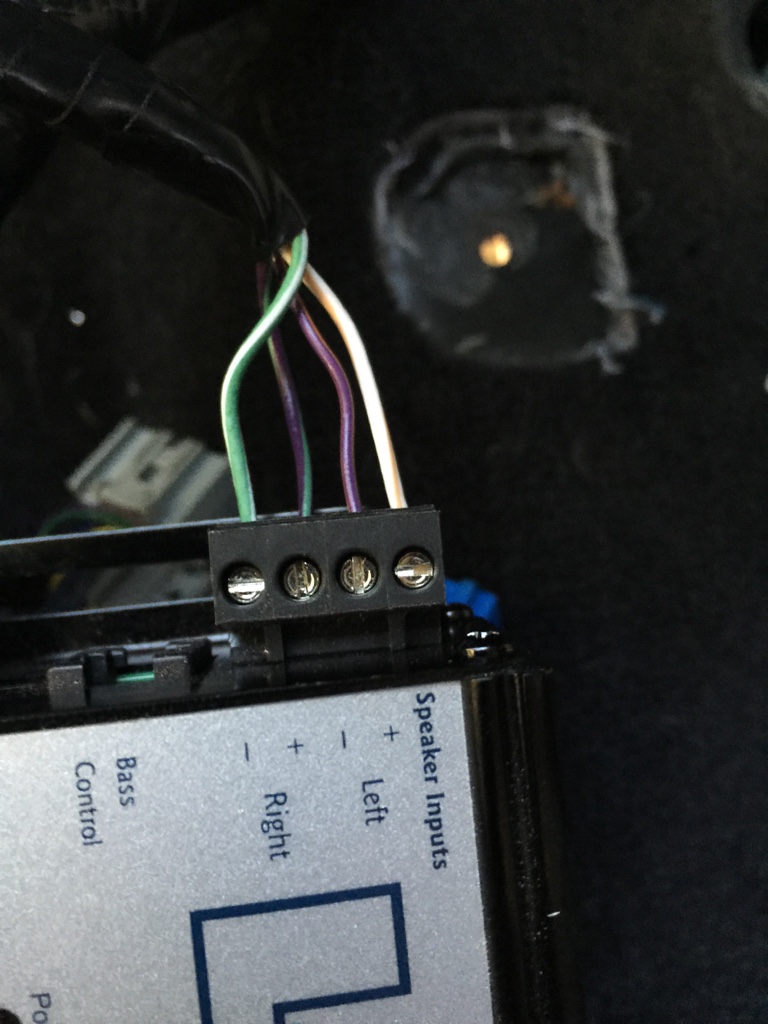

Next is the wiring part that I'm sure you guys will find most helpful. Here is a close up of the factory sub wires going into the LC2i.

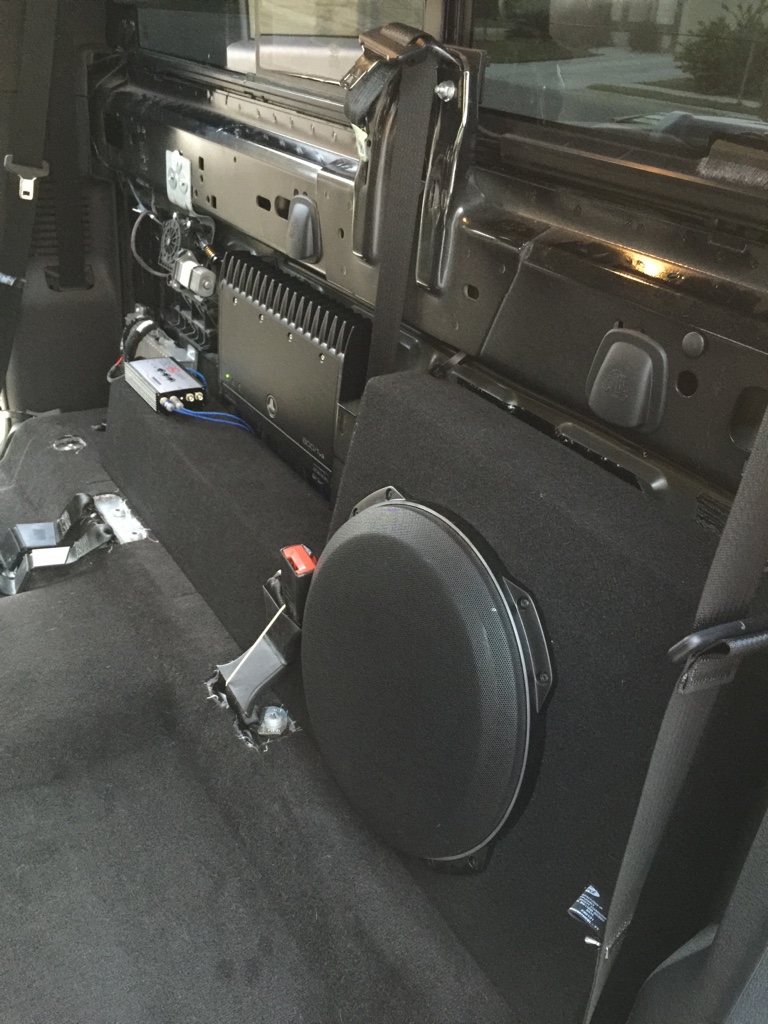

Once you have that done, mounting and cleaning up wires is about all that's left.
I should note that the LC2i has a function where it can provide the remote signal to turn on you amp... I felt that was more complicated than simply running a wire from the truck directly to the amp. I used the white with a blue stripe wire located in the "free bundle" of wires under the drivers side dash.
The LC2i will need power and ground though so I would use the big BLUE with RED stripe as the 12v+ and the BLACK with YEllOW stripe as the ground. These are located on one of the large plugs going into the factory Sony amp. I cut them and solder-spliced into them, and then shrink wrapped them.
Finally get everything dialed in and enjoy!
Note: on the 13tw5 sub, the protective screen does rub on the back seat when you fold it up and down. I'm sure you could remove the guard but I would rather leave it there.

Yeah man it really isn't bad. The hardest part is finding the space to move and rearrange stuff. Also, moving the window motor aside was cake and it still functions perfect. :ford:
