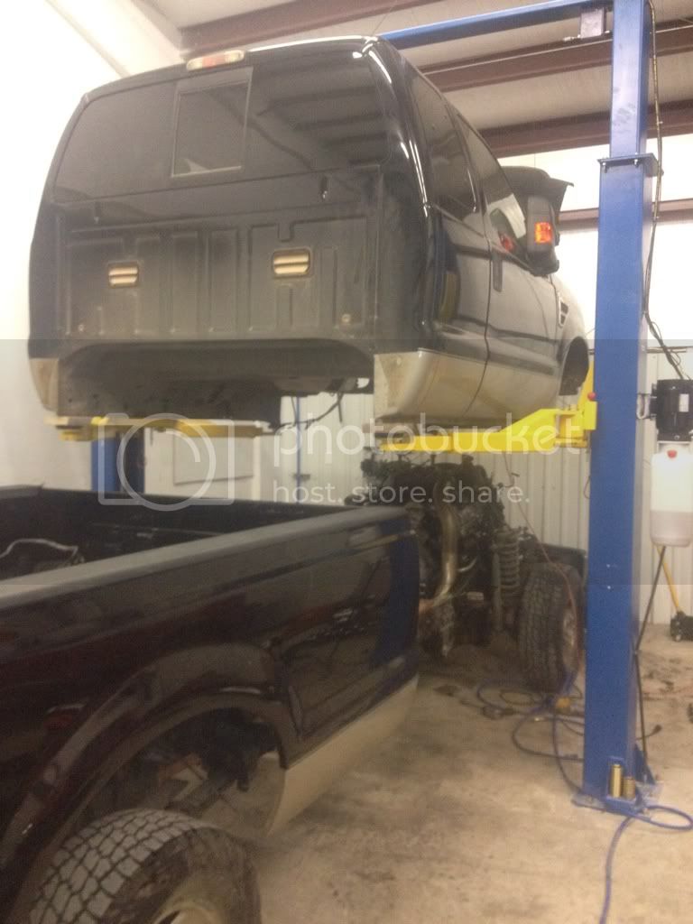

thanks! this is from when I pulled the cab right after the lift was put it to fix the oil drain leak.

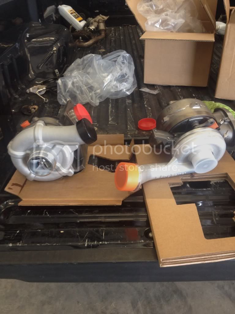

well I put these little guys on today..
The truck FINALLY drives right. Check engine light free. It is very awesome. Big thanks to Shane (whitemonster), Dzchevy21 and Colton for the MAP sensor (Super08Duty)
and yes I removed the two bolts connecting the two turbos once I got them in the truck. didn't want them to separate while they were on the hoist.
