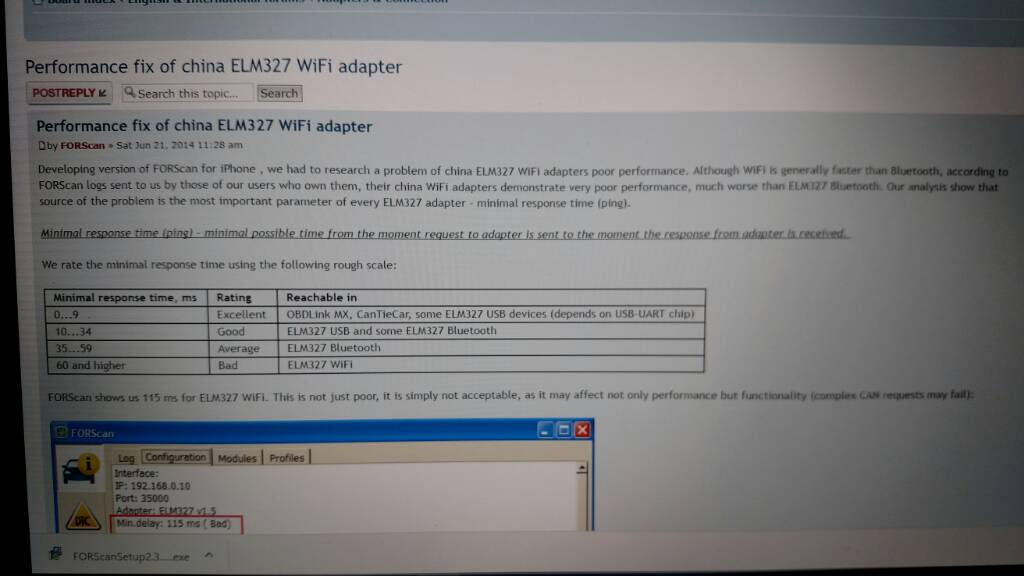

Apparently there is an issue with some of the China ELM327 adapters? From their forum- Performance fix of China ELM327 WiFi adapter
http://forscan.org/forum/viewtopic.php?f=4&t=16

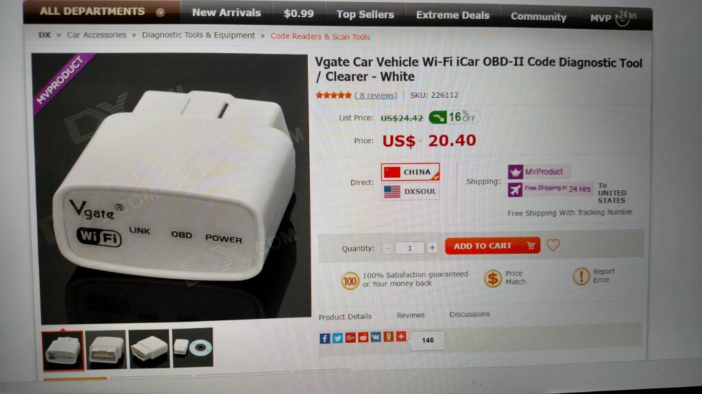

Any of them that can work on a 7.3 with an iPhone?
According to what I'm seeing in the FORScan site, performance issues seem to be based on minimal response time (ping).
Magnum, that forum post has some good responses with reviews that may help with decisions for iOS.
Vgate elm327 seems to be hit or miss. You don't want v1.5 and the iCar2 adapter is slow- they recommended this one instead based on user feedback if you're going China vgate.
Pricier, but sounds like a better option overall- the OBDLink MX WiFi has built in MS CAN support, apparently doesn't get as hot as the China adapters and is 3-4x faster as well. 👍

SO, does this one not work either?
I think PDT1081 has it mixed up. All (I think all anyway) can read the HS-CAN (HS is high speed btw) which is really all you need. No if it has a physical switch on the adapter then you can switch it over to the MS-CAN (MS is medium speed). MS-CAN will open up a couple other modules to read/write, but the majority are HS-CAN: IPC, PCM, BCM, TCM, etc
Yours is normal in that it can read HS, but just by chance you didn't find one with the MS switch. That's ok, you should be just fine using it for FORScan
According to jetexpress, it does work. If you read his post in this thread he has a list of modules that use hs-scan and the ones that use ms-can.
