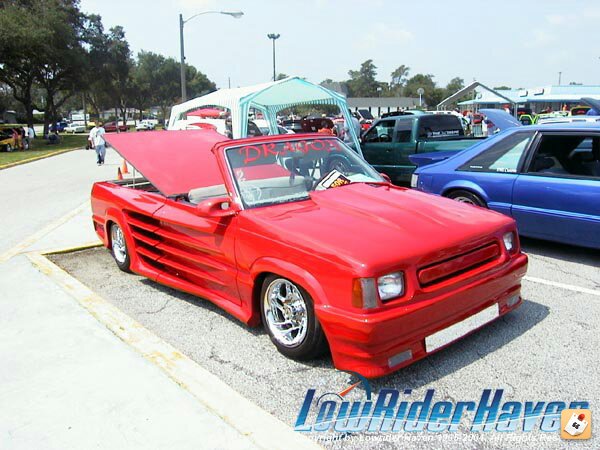

2. what are you doing to make it a widebody? new fenders? i skimmed but didn't see anything about it...
PTSUPERD
May 16, 2011
9,115
This is the pic he put up on IG to give folks an idea. I dig it.

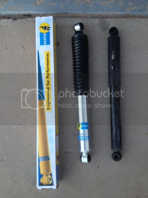

Apparently it had some rear shocks off a Nissan Titan and they just weren't cutting it. So after talking to Bilstein technical support we came up with shocks off a 80's Chevy Suburban, closest in valving and shock travel
Possible to get the Bilstein shock part #?

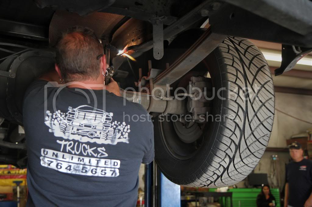

Also finally fixed the "bottoming out" issue once and for all with the help of a buddy and his torch.....
And not to be naive but guessing they just cut the bump stop mounting brackets off? Mine are smashed, and I can't really ride with the help bags aired out.
Thanks and truck looks great!
Shock part #'s are 24-197779 front and 33-185590 rear......the rear bump stops were already off the truck, but there was still a 3/4-1" lip off the frame the axle was still hitting when I'd hit a big bump in the road, so we cut that off along with notching the shock brackets (where the frame was hitting) and so far its given me all the room I need now
