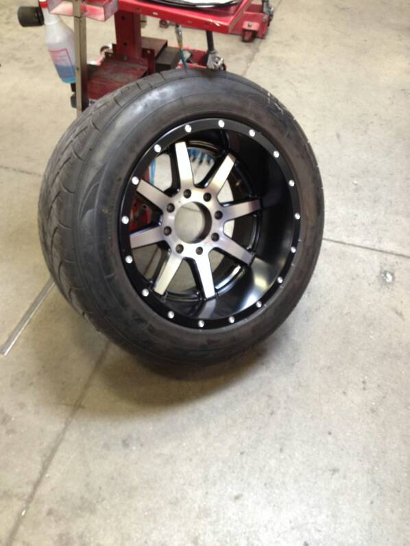

Julian just sent me this, 2 down 2 to go. Had a little issue yesterday getting the tires to seat, but they are getting it done today.

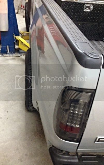

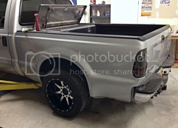

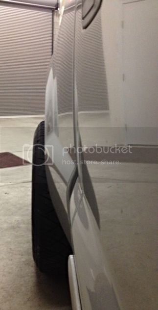

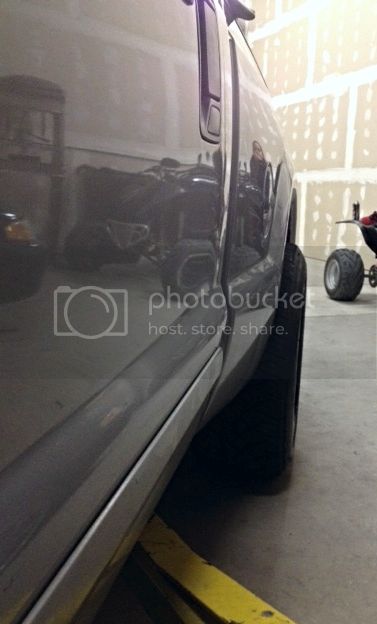

Its been a looooong weekend, to say the least.....only to be capped off with not having the right thread pitch on the lug nuts, but the fender work is done and despite the two screw ups on the bed, it came out bitchin..... I'm very pleased, and remember these are 20x12s and its no where near stance position because of not having lugs, but I had to see what it would kinda look like.....
Passenger side....
Driver side
Full side shot....

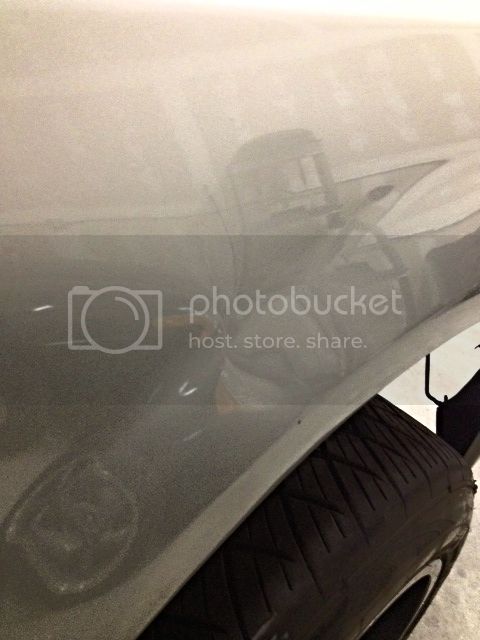

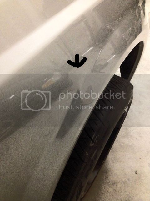

Now the bad.....here is one of the two hard lessons learned, couldn't get the other one to really show up on the camera

Damn... that looks good better than I thought in my head
that sucks on the crease, did it do it on both sides?
No just the driver, as I wanted to work with the fuel filler neck first to make sure I wasn't getting too crazy, which happened anyway, but like I said, now I know and I get the feeling I'll be doing this a few more times

Yes and no.......I thought I could maybe get away with just removing the two lower bedside support brackets and cutting the welded in plate in the inner wheel well......I was wrong.
In order to get the amount of flare that I got, you have to drill out the 5 spot welds on the bottom back corner of the bed, 3 behind the bumper and two underneath. That will let you by yourself, (instead of two buddies pulling) slide a scissor jack between the inner and outter bedside. A bottle jack, which is the tool of choice wont work, there isn't enough room. I was able to slide a 2ft 2x4 on top of the scissor jack......this was mistake #2, I don't know if it wasn't long enough or if I just got too carried away, but this caused crease 1 and 2. I found it actually worked better to slide the scissor jack in the cut you made earlier one inner fender well plate and jacking it open from there.....no creases when doing that LOL.

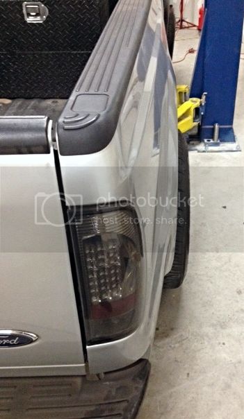

Is it just me or is the bumper to bed gap all out of whack here? Is it just ****ty bumper fitment or did flaring the bedsides screw with it?
he had to cut the spotwelds at the back there so the whole bedside could move out i believe. what you are seeing is a gap that was previously welded together.
It's just you Mr Picky LOL.....fitment is factory, may look a lil strange as its showing factory primer from the inner part of the bed, but nothing as changed there, except for the over lap of the out skin has move a little.......its funny how you don't notice how bad or off factory fitment is until you start messing with it, much like the front bumper and fender alignment
