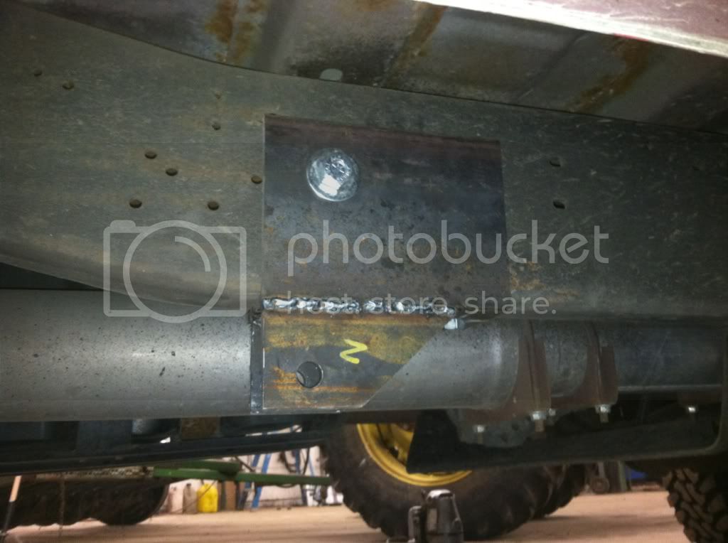

Here is a couple pics of mine

Thanks for the help guys I went the bolted on route... There's a 5/8s bolt on the side... And two on the bottom
