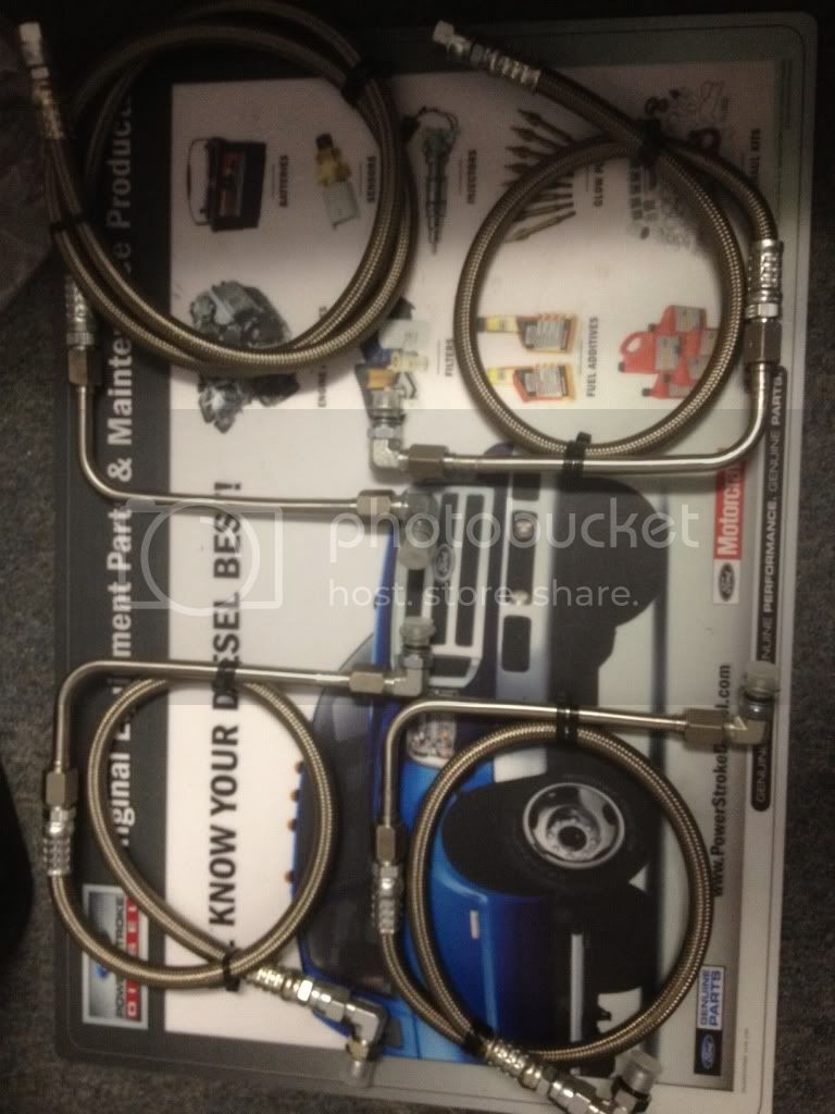

java
Aug 24, 2011
1,673
Texas
These are the only pics I have of my fuel bowl delete. (the one that 09stroker is talking about.)

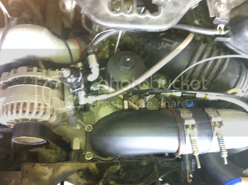

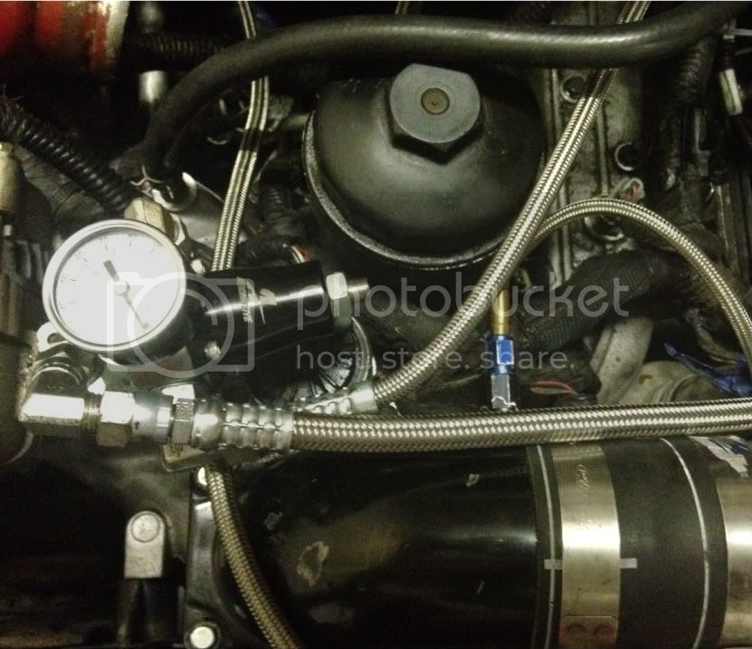

09stroker
1,300
Texas
This shows the connection where the quick connect adapter was under the truck. We used a -8 AN union and two -8 Push-Lok to AN hose ends, but simply using a -8 Push-Lok union would be easier.
This is just a shot of the tee and lines going to the front of the heads.
