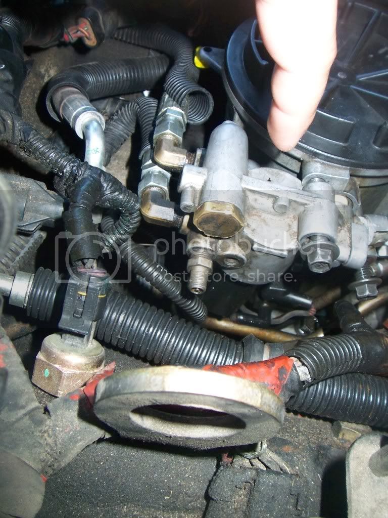

I believe the screen everyone says to clean is the fpr screen. It's on the drivers side of the bowl. Maybe some one will post a pic of it since my fuel bowl is m.i.a do to the exact leaks your talking about.

the screen everyone refers to is between the frp and bowl. If you look at the picture between the 2 bolts you can see a white/yellow looking thing showing THAT IS THE SCREEN. Also if you are going to take out your fuel bowl take the heater out of it, as long as it dont get to cold where you live, some people will even tell you to take it out regardless. It will keep from fuse #22 from poping. It makes cleaning you fuel bowl easier, I do it everytime I replace my filter. Just remember that the pole/ stick is reverse threaded.
