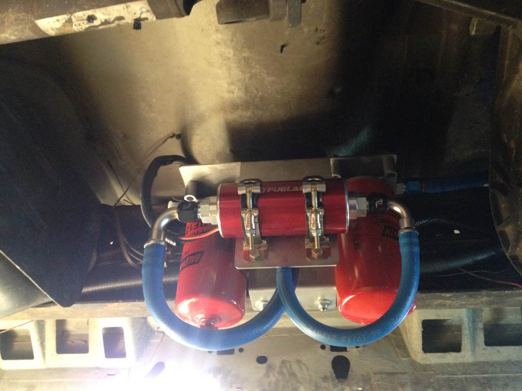

Finally got all my parts in for the new fuel system, minus one pushlok fitting from the local speed shop. So I installed the Fuel pump and filters from Irate and got it plumbed and wired in, except for the suction going to the tank today. Still waiting on a fitting.

That's a nice setup, just don't like how the hoses hang down. Can you loop them over the top?
neverkickn
2,692
AR
Thanks man. You get the new injectors in yet?
