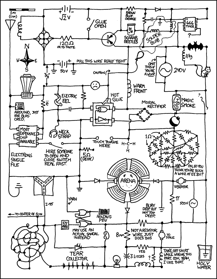

I was doing a little electronics shopping on the web and found the circuit you need to build to make your pump work - please follow the directions completely!
TARM
May 19, 2011
2,439
That's some funny stuff. Where did you find that. I have got to save that and use it down the road.
