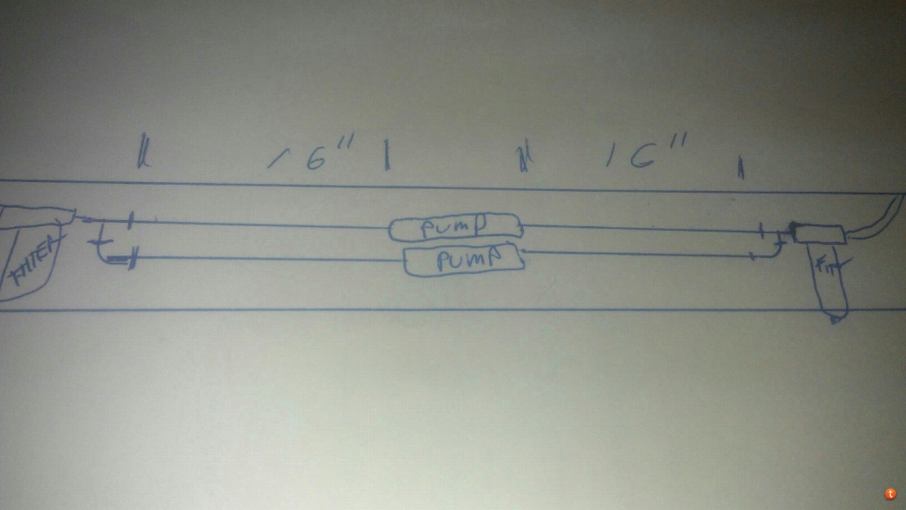

Forgive the 4th grade drawing. I spaced everything out on mine. 16 inches or so between pumps and filters, used a T and a 90 coming out and going in to each filter base. Looks a lot cleaner than a cluster bomb of pumps filters firings and wiring. And is a lot easier to work on IMO
Sent from my HTC PH39100 using Tapatalk

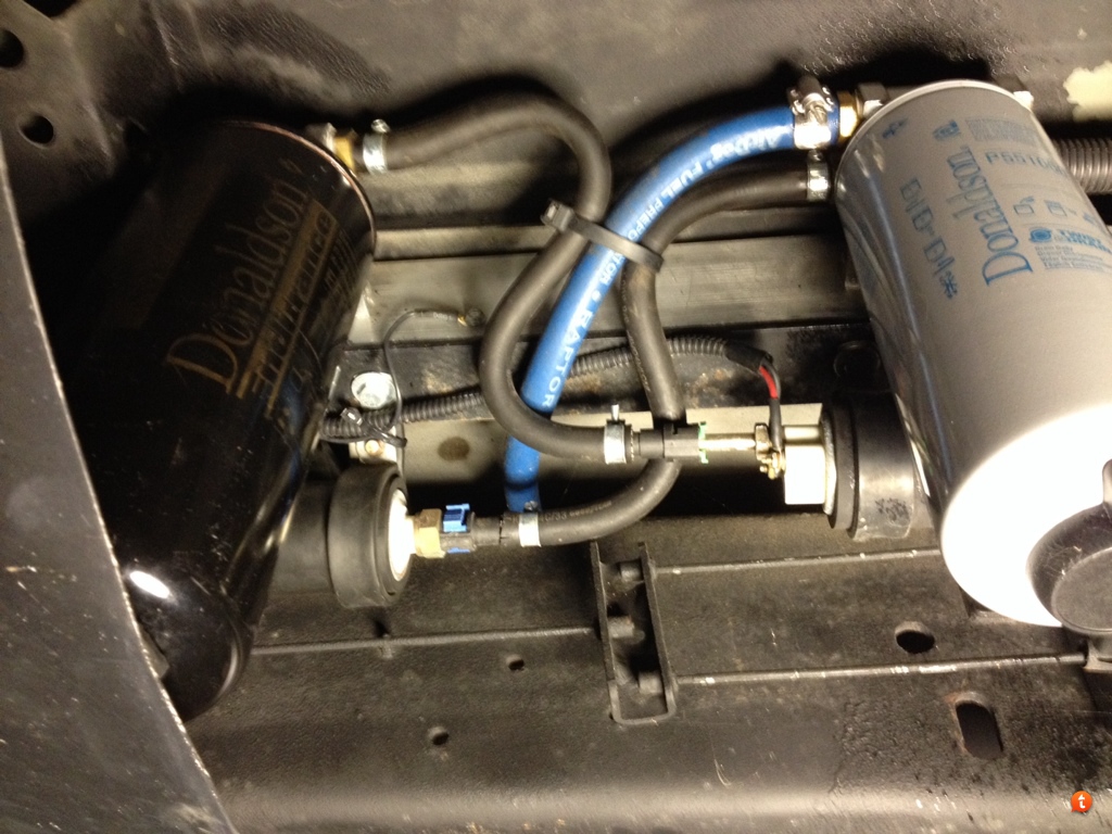

Lines have been re routed.
Blue line from sump, pre filter, then split to pumps, final filter.
Filter bases have two inputs and two outputs.
But you get the idea.
Bought the two pumps off flea bay.
One went out on me and I noticed it drop press to 50 psi during hard run.
With 350,200s on a low hp tune.
Pulled over and what do ya know one was not working.
Started it back up and drove it home.
I like the insurance of being able to get home.
Pair that with oem pumps, and you're golden.

No "T"a needed with the multiple input output filter bases.
