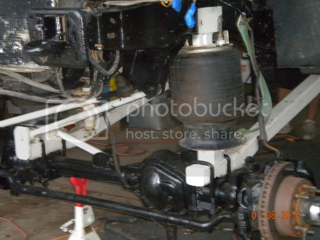

Build your own!! Its way easy. I used a 5 gal tank & the elec. compressor & digital air ride control so I have control over each not just front or back like most kits. I think it was around $500 for the tank, comp, electronics kit from Airlift Co.

Just scale this down a lot or even make it a 4 link if you want my 2 link with a pan hard bar is a very simple system.
That setup has zero articulation. Its going to flex the truck frame a lot, ride poorly and someday it will break an axle tube.
Before I did that, I would steal the radius arm front suspension off an 06+ Superduty. The Ford setup mounts the radius arms to the diff with 2 big rubber bushings on each side, thus allowing articulation.
Uhmmm not at all actually there is 0 frame stress this thing handles very well on the highway & backroads, and it has about 18 inches of articulation. Im not sure what pic U were looking at :doh: Its been air born a couple times on the dunes 239,000 miles on stock axle tubes. Do you build air ride lifts & suspension for a living??? If so maybe you could teach me a couple things or vise versa. Just saying. Thus giving me more articulation then any 4 link could ever dream of.
