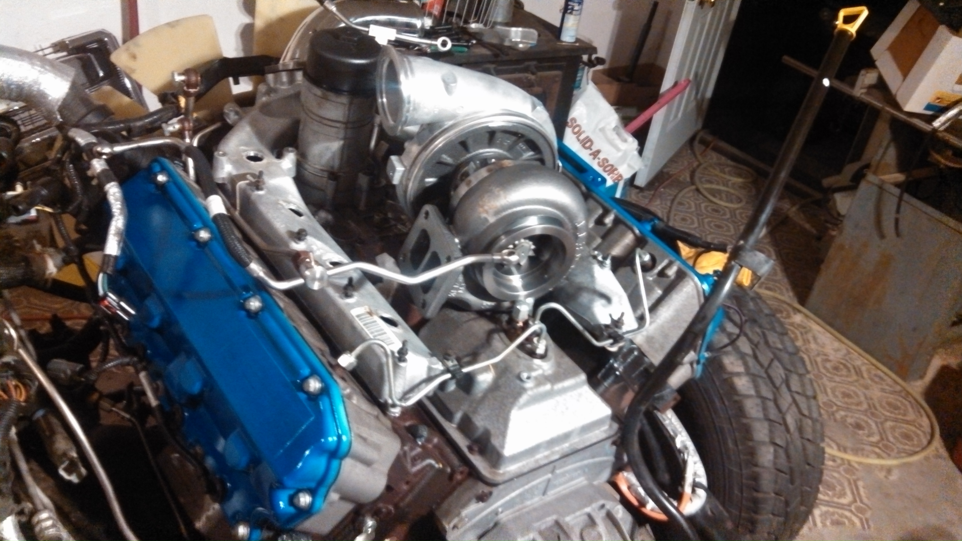

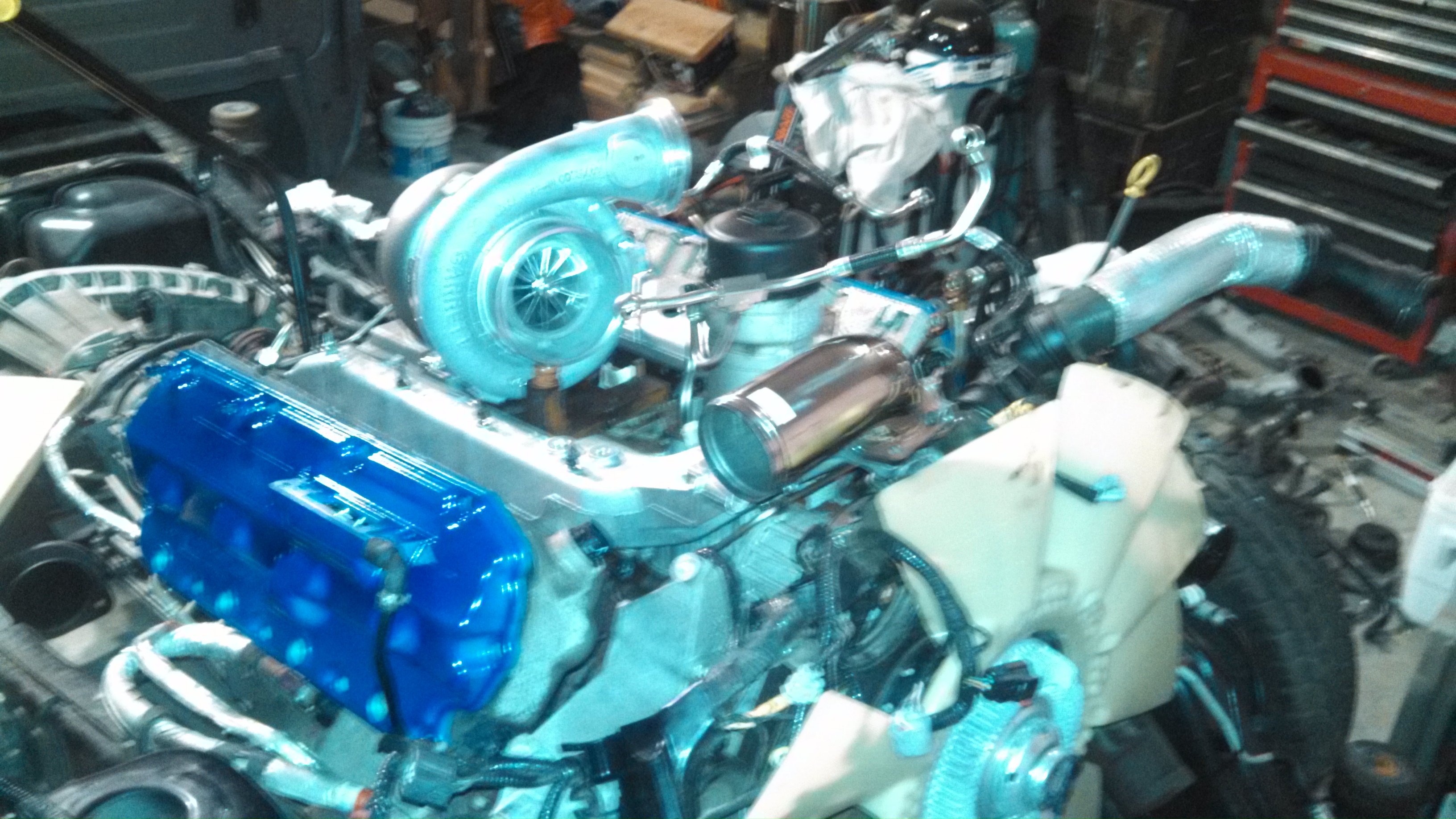

Colton what did you dyno on fuel?

Know what exhaust housing was in it?

780 at low boost. Couldn't hit full boost on the dyno without spray. Hoping there's a good dyno at Ennis so I can try for full boost on fuel.
Unless its a full load cell its probably not going to happen.
