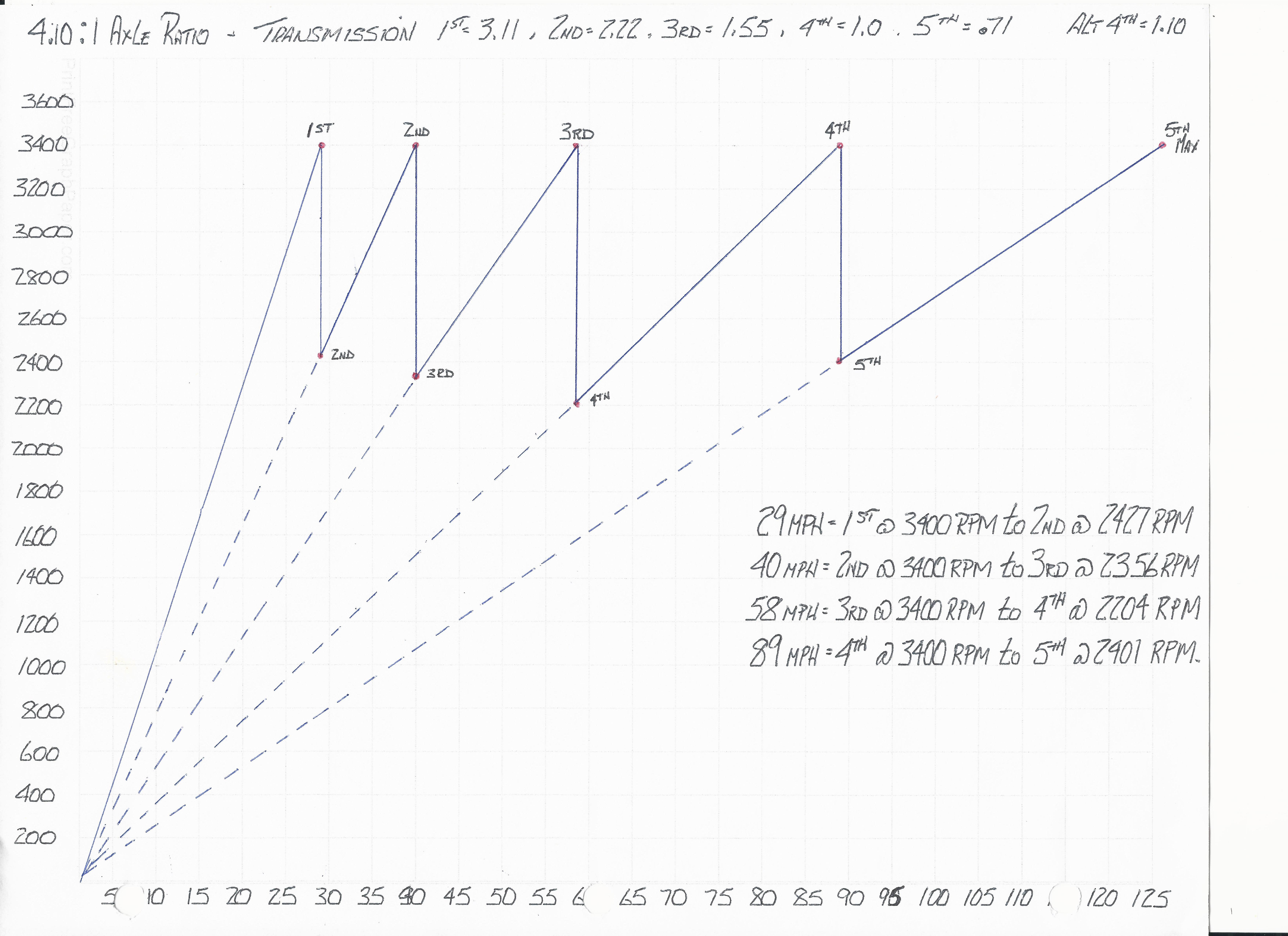

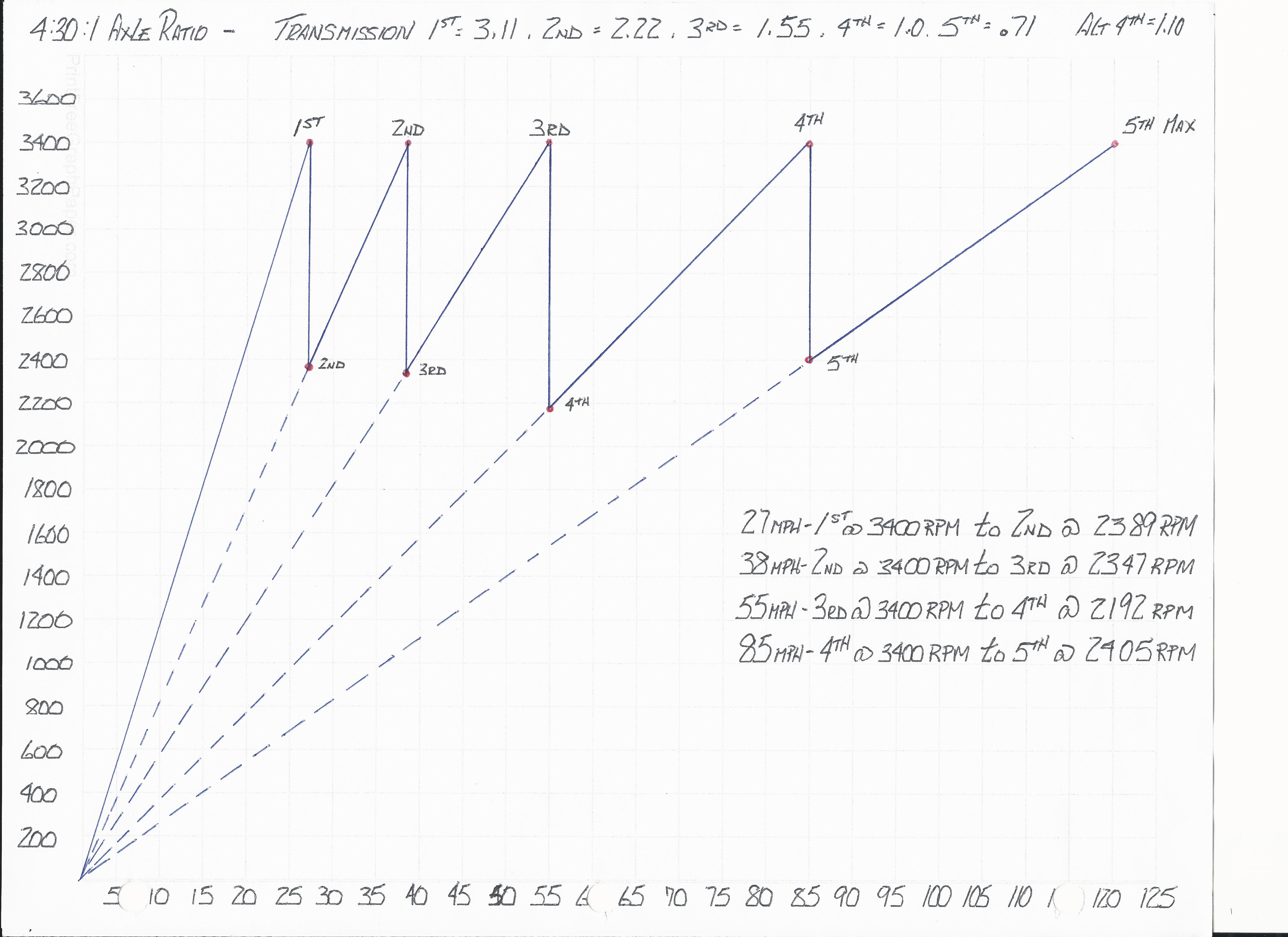

I run a 37" tire that has an actual workin diameter of 36.25". I travel a lot on highways @ 70-75 mph a lot of the time. I finally decided to go with 4.10's. this gave me decent rpm on the highway but still improved my off the line snap over the OEM 3.55 ratio. The 4.10's also allow me to drop to a 35" tire in the future if I need to.
When I was trying to decide what ratio to go with I calculated a couple of graphs that allowed me to pin point any RPM & speed in any gear with either ratio. This helped with my decision.
