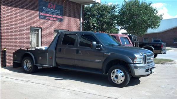

Just bought an 05 F550 to tow the Fifth wheel(ya ya ya I bought a six leaker and I am old and wanna go camping with the wife and grand kids)that's for the poking that will come shortly:swordfight:
Truck has 4.88's and cruises 70mph @ roughly 2650 RPM, for a 7.3 that is too high but not sure on the 6.0.
What have you guys seen that works best gear wise?
Gear vendors says not to tow in double over drive so not sure that will be a wise option vs swapping to 410's or 4.30's.
Truck and trailer only weighs 22000lbs, my 2000 F250 pulled it fine with 3.73's and a stock turbo but it weighed 2500lbs less than the 550.
What is an average acceptable towing mileage for a big fifth wheel?

I don't THINK your mileage will change much while loaded with the OD or not, but the 6.0 would probably appreciate the RPM's a lot more.

If your towing heavy my buddies 6.0 always liked a few rpm's. As far as the gv overdrive, I've heard they don't handle diesels very well.

1) Swap gears - you'll hate that overdrive unit the first time it fails on you with a load behind you.

Agreed. That O/D unit won't hold up very long, when it slips and strands you you'll be pissed. If the truck is a 2wd, it'll be cheaper to regear it anyways...

Cheaper and more reliable to throw 4.10's at her. That gear will move the weight just fine to. I would guess your fuel mileage will be around 12MPG also, depending on driving habits and weather.

I must have a rare gv. I tow the crap out of mine in double OD. For the last 80,000 miles. No problems. (29,200 last i weighted )Also the only way I think they will leave your stranded is if your tear the oneway clutch out of it. Most people have problems with friction clutch which then they just dont engage but you still have direct. But i will also admit they are not for everyone. Sometimes towing i just want to drive and not worry about shifting. Unloaded i just leave it in.
