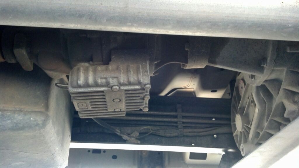

K. Its still a work truck so dont mind the dirt. uploadfromtaptalk1341928474016.jpg

So it bolted directly onto the output from your transfer case. My guess is it would do the same with a ZF-6.
How exactly are they controlled? Is it just a switch that you flip and it shifts?
I would imagine. Just change the tail section out for the gv adapter plate. They are computer controlled to help keep the operator from wrecking it. Although it sill happens. There would be a push pull switch mounted on your shifter or you can put a switch in the floor like the old high/low beam sw
