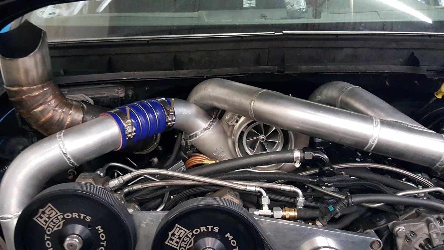

There is no Cp3 conversion. CP3 won't fit. We tried. closest we ever got was gutting the cp4 and running 2 big ass cp3's..... Works well.
