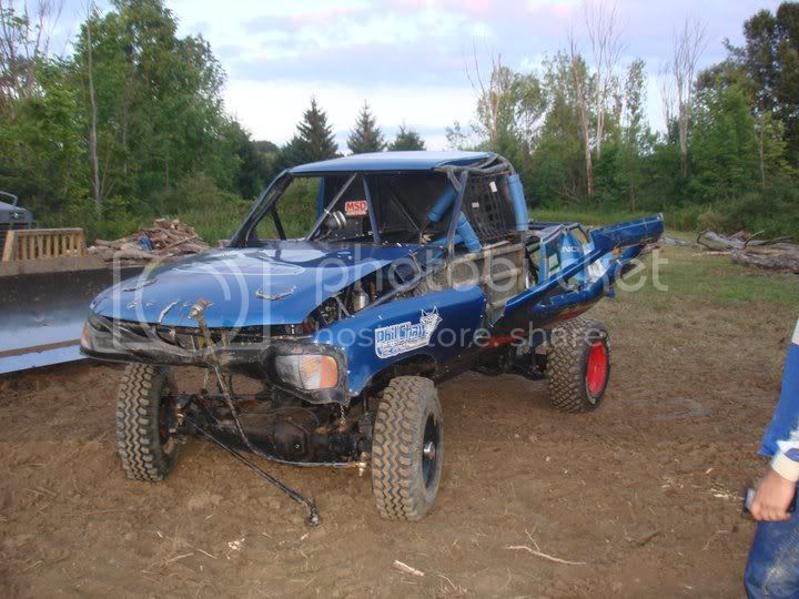

speaking of makin sure you build a good cage
http://youtu.be/-U_Pk3iqOGI
had a caliper hang up, lock up the drivetrain, and upon landing with locked up wheels ( a huge no no) it sheared off the sector shaft in the gear box which turned the wheels hard right, shattered the drivers side outter axle, snapped the pass side knuckle, and the momentum of the truck proceded to roll it. Not the most violent roll ive had, but came at the most inconvenient time possible, next day was a big race at our local fair. oh well, back to the drawing board. Parts are on order, should be back up and runnin in a couple weeks, yet there lies the silver lining to all breakage, forced upgrade!! and for those of you that are wondering, that tie rod is solid 1.25" 4340, and every Evolution Machine heim is still straight and true.

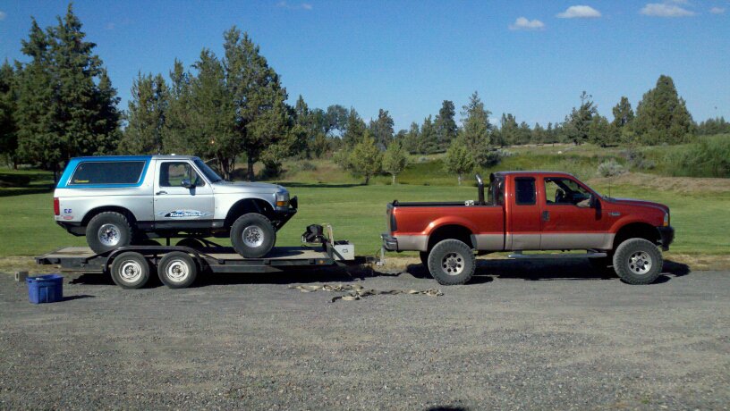

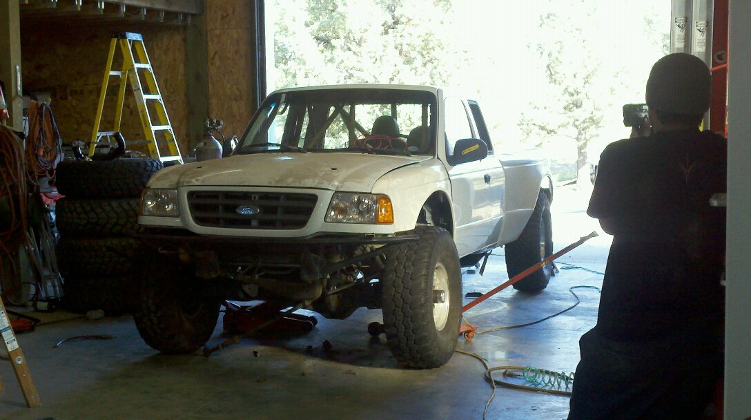

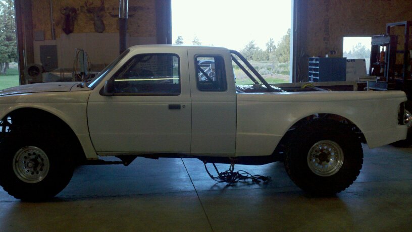

18" of front travel and 24" of rear end travel, full 1 3/4 4340 cage, 3" coilovers all the way around with a set of 3" bypasses right along side em. full plated and gusseted 9" and a dana 44 out of a bronco in the front with custom mounts to make it work and cycle properly. one day it will be finished.. not sure when that day will come.. untill then we play with the bronco
