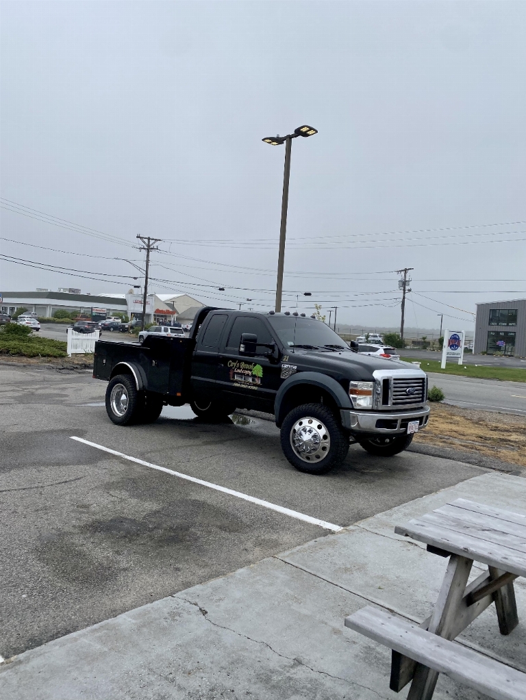

Been a minute, I’ve been busy though. Still have the hd, but working on my work truck mostly right now. Pulled the minimaxx out of the silver truck I bought off here in ‘19, but it’s a street model and the high sulfur code generated online isn’t working, so I can’t do some of the work I want to. Also trying to work out an AC issue, but enjoying it.
Engine from the silver truck will go into the Harley while I work on the built engine. I have a stack of parts for it accumulating and some cash to run by the machine shop. Hoping things slow down around here so I can work on my trucks more and spend some more time around psa.
