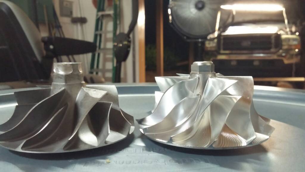

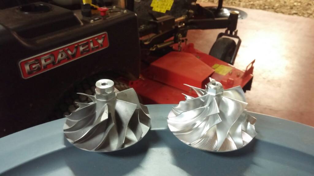

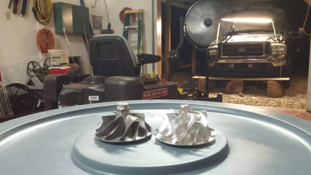

uploadfromtaptalk1409106121860.jpguploadfromtaptalk1409106161484.jpguploadfromtaptalk1409106182694.jpg
Just a few pics of the stock 38r wheel next to riff raff wheel

Is anybody else watching this suspecting the billet wheel having a role in egts being higher? I'm off by 150 degrees and it's the only thing left. It's quiet, it does make more boost but I've replaced boots, pressure tested the charge system, and even changed hpo pumps.

Mine felt like it was under the turbo all the time, down shifting pulling an empty trailer where it used to pull in OD no problem
Put the stock 38R wheel back Bam back in business
It did sound like it was moving a ton of air at higher boost and it may be better at "peak" boost but for me it didn't seem better
No kidding!? Man, I felt crazy pondering it. But it just seems to be. God blessed. I'm going to have to switch it out.
