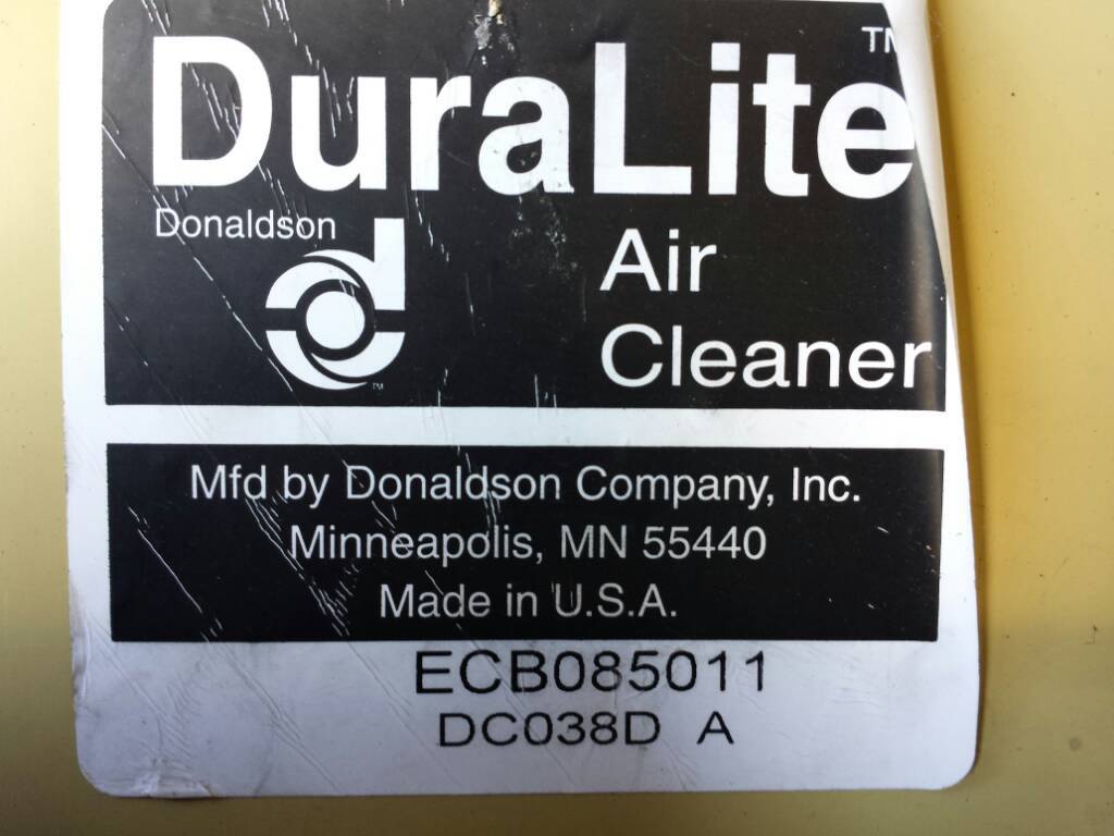

I was simply throwing a thought out for discussion. What do you think they coat the Donaldson filter media with? I would think it has to be something some what similar.

no. not even close. the Donaldson is hydrophobic as in when it gets wet it doesnt change the characteristics of the filter.. the spray seals whatever it is sprayed on and will not allow anything to pass through it.. the ais filter is the best replacement for the stock box but performance wise tge Donaldson is gonna win.. the ais will perform well and if noise is an issue then it is what I would use. or try to build a box around the Donaldson filter to help cut down the noise.

I make filter media all the time at work from pp fibers. Pp is inherently hydrophobic. I have to introduce a wetting agent to allow water to penetrate it and thus reach the super absorbant bound to it. Not sure what these filters are made of but I'm sure they could potentially be treated with a hydrophobic material that would not significantly increase the fiber size thus not significantly effecting the pressure drop through the filter. Does anyone have an idea what the Donaldson might be made from?
ja_cain
Aug 10, 2013
4,597
The Donaldson filters could also be made from a fluorinated polymer which greatly increases the contact angle if water thus making it highly hydrophobic. Pvdf is one that we compound into our pp fibers all of the time. We also make fibers exclusively from it to.
