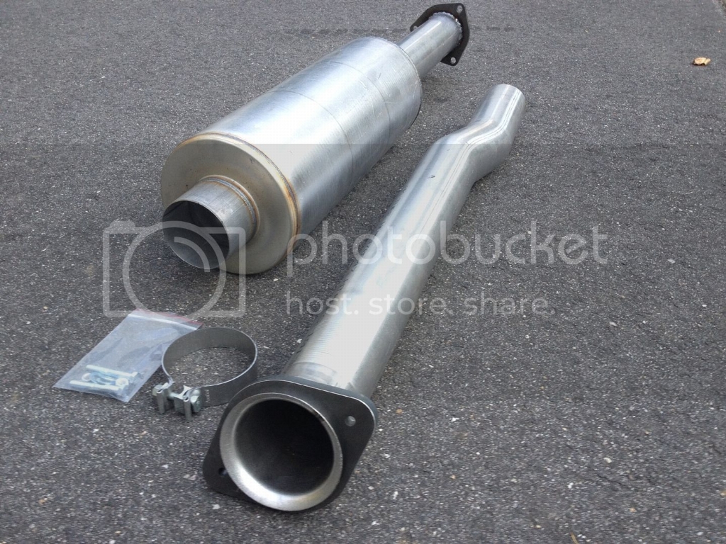

I just went with a MBRP set up. I like that old school look with two pipes coming out the corners..lol Its called there cool duals. I have DPF on and the system connected right after the Cat. Looks good, sounds just like stock with better breathing. I was wanting just a little more sound than stock, but am leaving it alone for now. Call Steve at Absolute Performance or Eric at Innovative diesel, both great guys with excellent pricing that will build you a package if you want to go in that direction. Good Luck.
