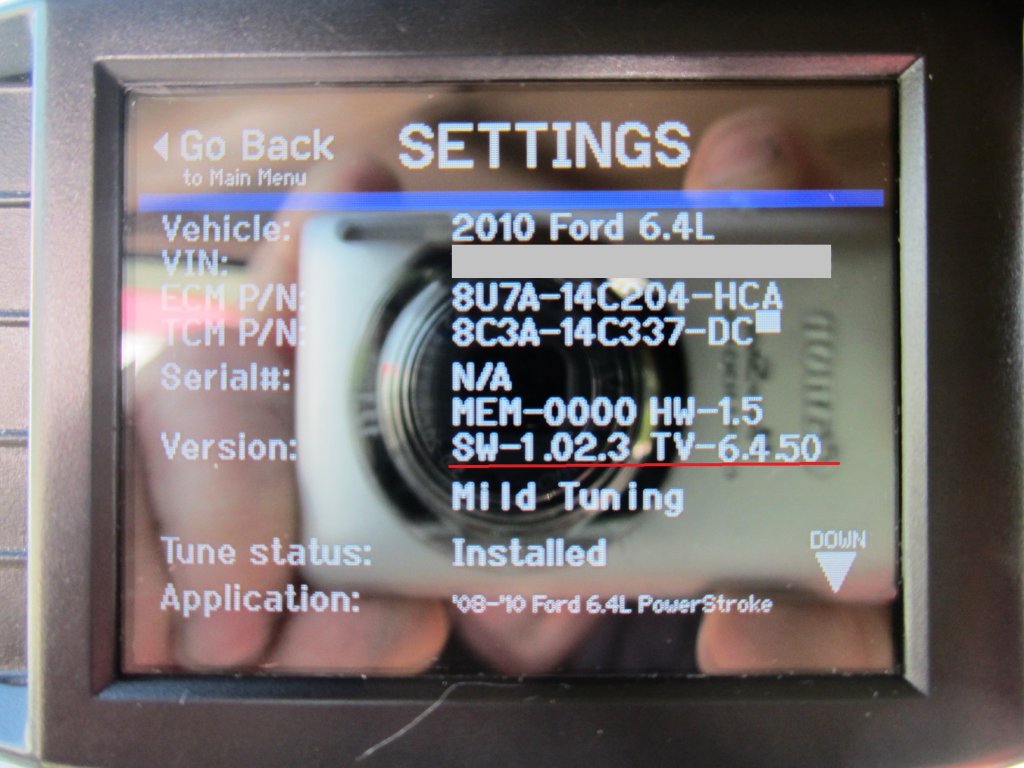

What Tuning Version # (TV) is your program. Your H&S may be a knock off version with a hybrid tuning version installed. send me a PM with your e-mail and I will send you what I have.

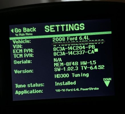

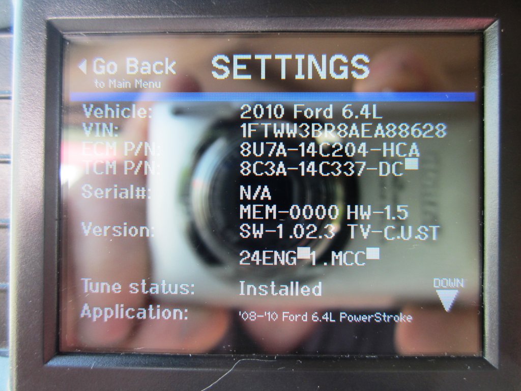

When I load the canned tunes the Verison # is, TV-6.4.52. When I load my custom tune the Version # is, TV-C.U.S.T.

That looks basically the same as mine. I thought 6.4.51 was the last update they made in August 2013. Maybe there was one more.
