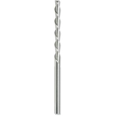

Bobby@cp
2,482
Buy this...... worked the best for me
