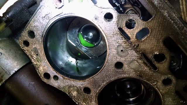

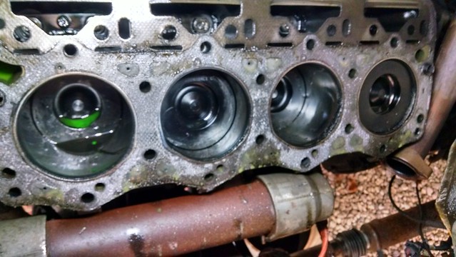

You can see in the second pic a very slight marking on the piston in #4 where I had some valve contact. That's where the bent push rod came from. Other than that, at just a quick glance the pistons look fine. No cracks or anything like that.
