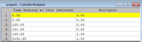

This one shows in second the time which it takes for hi-idle to engage without your foot the on break and it meets the temperature conditons.

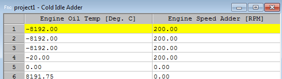

This is the cold idle adder showing the amount of idle rise based off of EOT in celcius. Roughy 200 rpm.

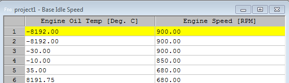

This shows the relation of the EOT sensor to idle speed.

Now then, show me how EOT has anything to do with the high idle function on a cold engine. We all see how RPM can vary with EOT (very slightly, and hardly enough to notice unless you are in extreme cold), but that is not the complaint here.

Those functions add to the idle speed. The 1st is the time it takes to add in the cold idle control, 2nd is the RPM that will be added vs IAT, and the 4th is RPM that will be added vs EOT. The only thing that will disable the cold idle control is your brake pedal and a EOT parameter that will turn it off after the preset temp is reached. The EOT vs RPM (#4) will always be there, regardless of what you are doing with the truck.
Also keep in mind this is all in Celsius.
You are just reading under hood temps instead of intake air temp....which for most aftermarket intakes is the same thing.....lol.

It makes perfect sense to me, I think you are the one having the issues understanding these basic PCM functions.
Where in the functions do you see anything that has to do with cold idle control (auto high idle) and EOT??? I agree EOT will kick it out of high idle around 160* Fahrenheit, and possibly add a few hundred RPM to the base idle when temps drop below -10* Fahrenheit....but otherwise it has no relation.
