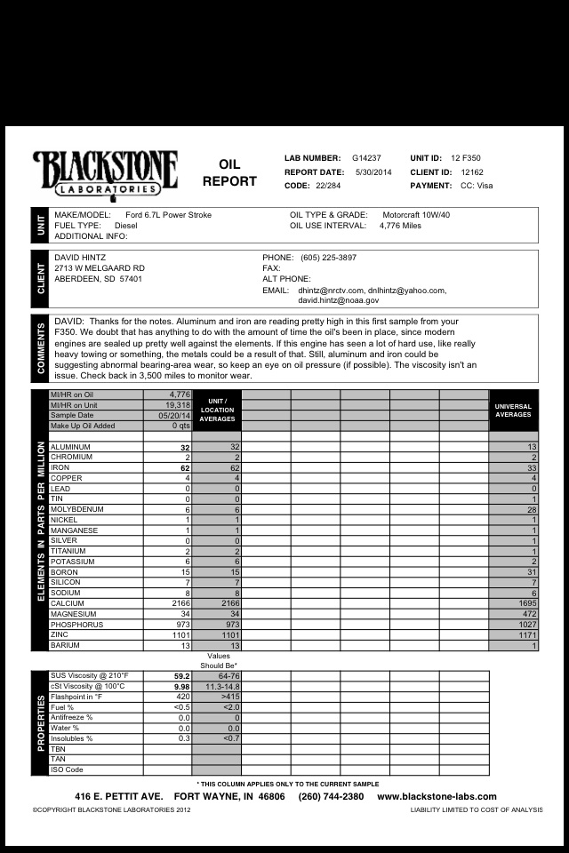

Hey guys need some opinions. I did my first oil change and sent off for an analysis. To be clear dealer did them before I did. Oil had 4776 miles on it and truck had 19xxx on the odometer. Blackstone came back and said that iron and aluminum was high (62 & 32 respectively). I don't tow a lot and when I do we cross the scales at 24k which I don't think is heavy and not out of the truck specs. They want me to resample at 3500 miles. Do I take this report into my dealer? I'm a bit freaked about this.
