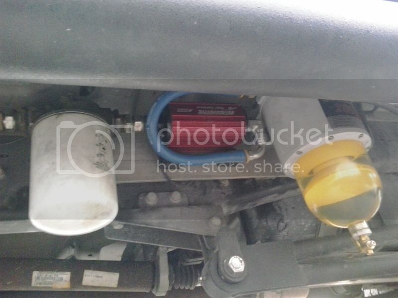

I am using a Dahl 200 with a 30 micron filter and have had no issues with my a1000. I might step up to the 10 micron since Dahl rates their filters as absolute and not nominal.
You have any issues with road debris hitting the filters? looks like you got it mounted on driver-side-outer frame rail.
Do you happen to drive it in the cold?
Jonnydime
Jun 26, 2012
2,319
8
I live in Florida so cold doesn't really happen but they make a heater for the filter if needed. I haven't had any issues with road debris but I have been thinking about making a shield for it when I have time.
