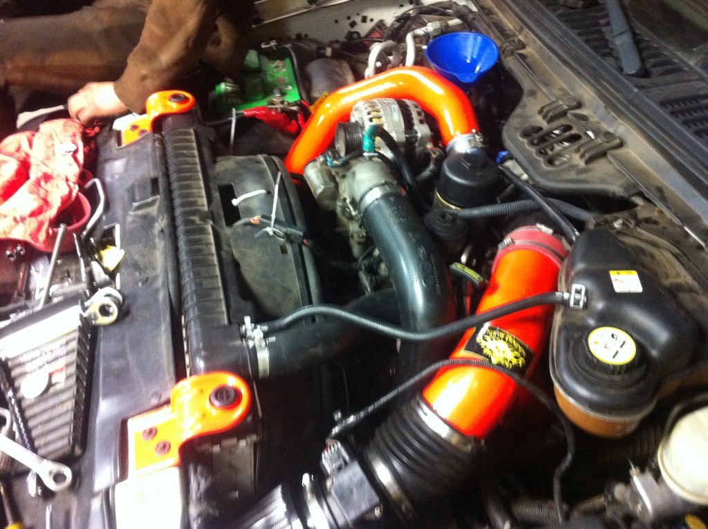

I had the s &b but my filter minder always pulls in when I get on it so I made my own from 4" ss pipe solved my minder issues and cost me about 60 in materials and a few hrs of my tig welding time

Did the same thing, it's pretty easy actually
Not the best photo but it's all I got

did either of you guys support the intake from the bottom? To keep it from sagging at the boot to the charger?

No support, only causes pain to install. Mine holds just fine
