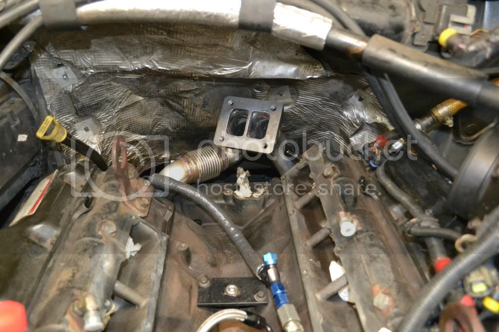

Pulling the mech pump, how do I retrieve the push rod, and what size frost plug fits it?
- Remove the bolts holding the fuel pump
- Do NOT remove pump at this time
- Bar the motor over until fuel pops up. Once it pops up, the cam lobe is blocking the hole so the rod can't fall.
To plug the hole, get yourself the drain adapter for a T4 conversion. The adapter is threaded and bolts in place.
The -4 return hoses reach the regulator if you mount it by the HPOP resevior.
The compression fittings I used are the Ermeto type available at the hydraulic store.
Put a ball valve before the filters. The fuel will gravity feed once you take the hose off the supply line. All mods are done after the selector valve.
Let me know if need any other assistance.
Here are some pics to help you out
Before T4 conversion (E fuel conversion)

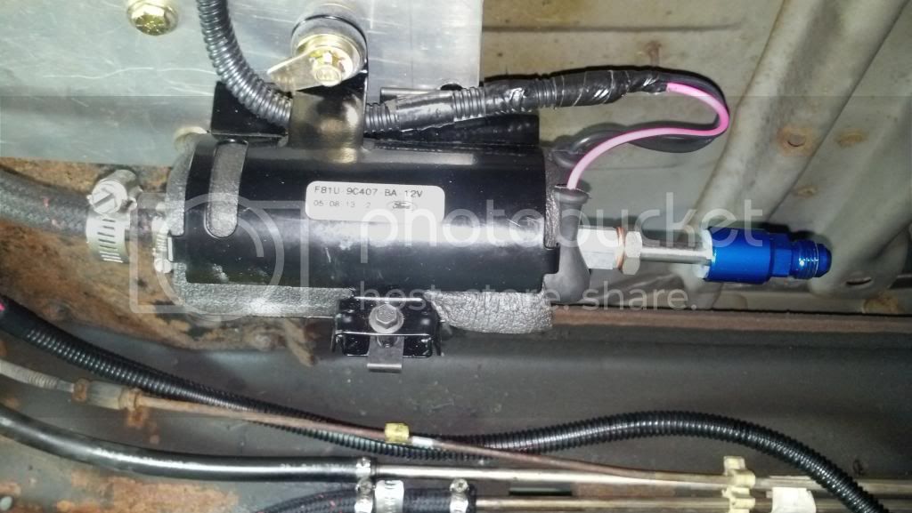

- Use the fuel heater as your relay coil wire.
- I ran 10 ga wire to the pump to eliminated any chance of voltage drop
- A sealed Bosch 40A relay is recommended
- I just run a relay to control the fuel pump. I was running a NO/NC oil pressure switch and it malfunctioned, so I eliminated it.

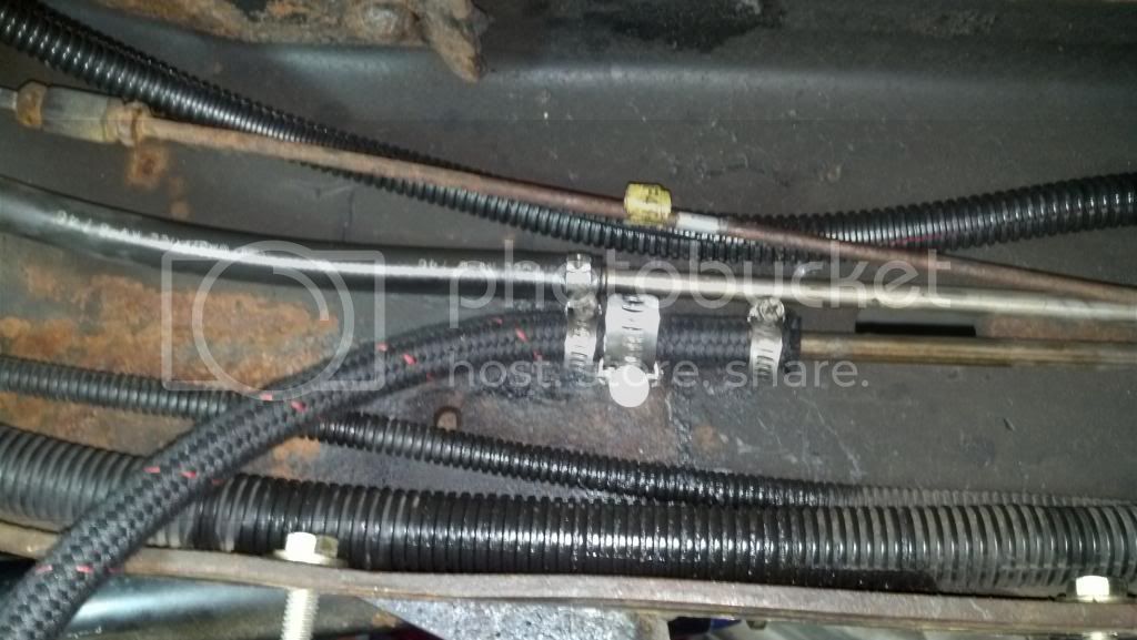

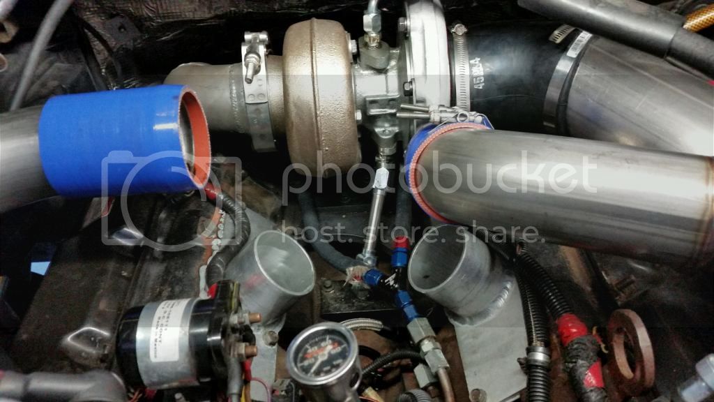

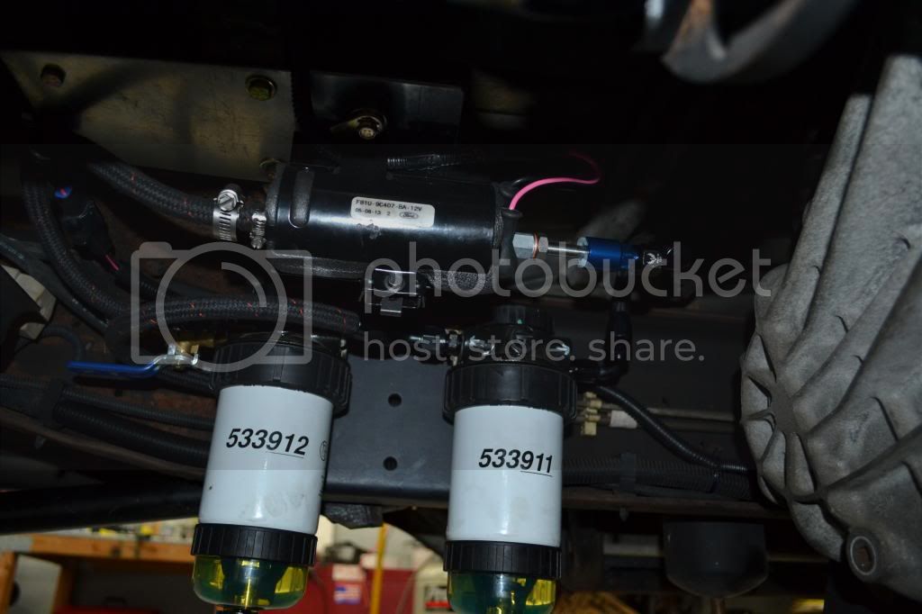

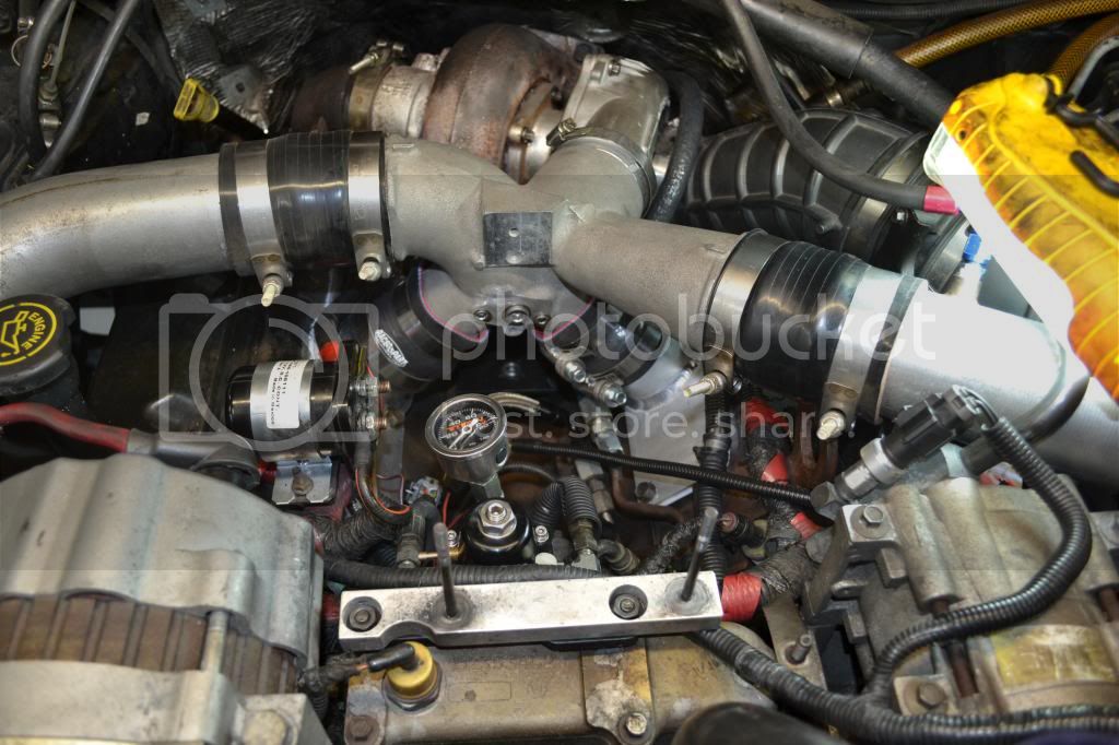

Thanks for the help, I finally got time to work on this, also due to needing to move the 5th wheel this weekend into storage. I don't have everything put together the way I want it permanently but it works for now with no leaks. I had the pump mounted vertically between the filters but found out that wasn't going to work, so I had to take it back apart and build a "stand" for it so it now sits horizontal in front of the filters. Truck runs like a raped ape now compared to before, I'm very happy. It runs very smooth, I think I was loosing a lot of power before e fuel. Apparently loosing the exh back pressure sensor isn't that big of a deal as it runs very well. This truck is going in for a lot of work this winter ( I don't drive it in the winter).
