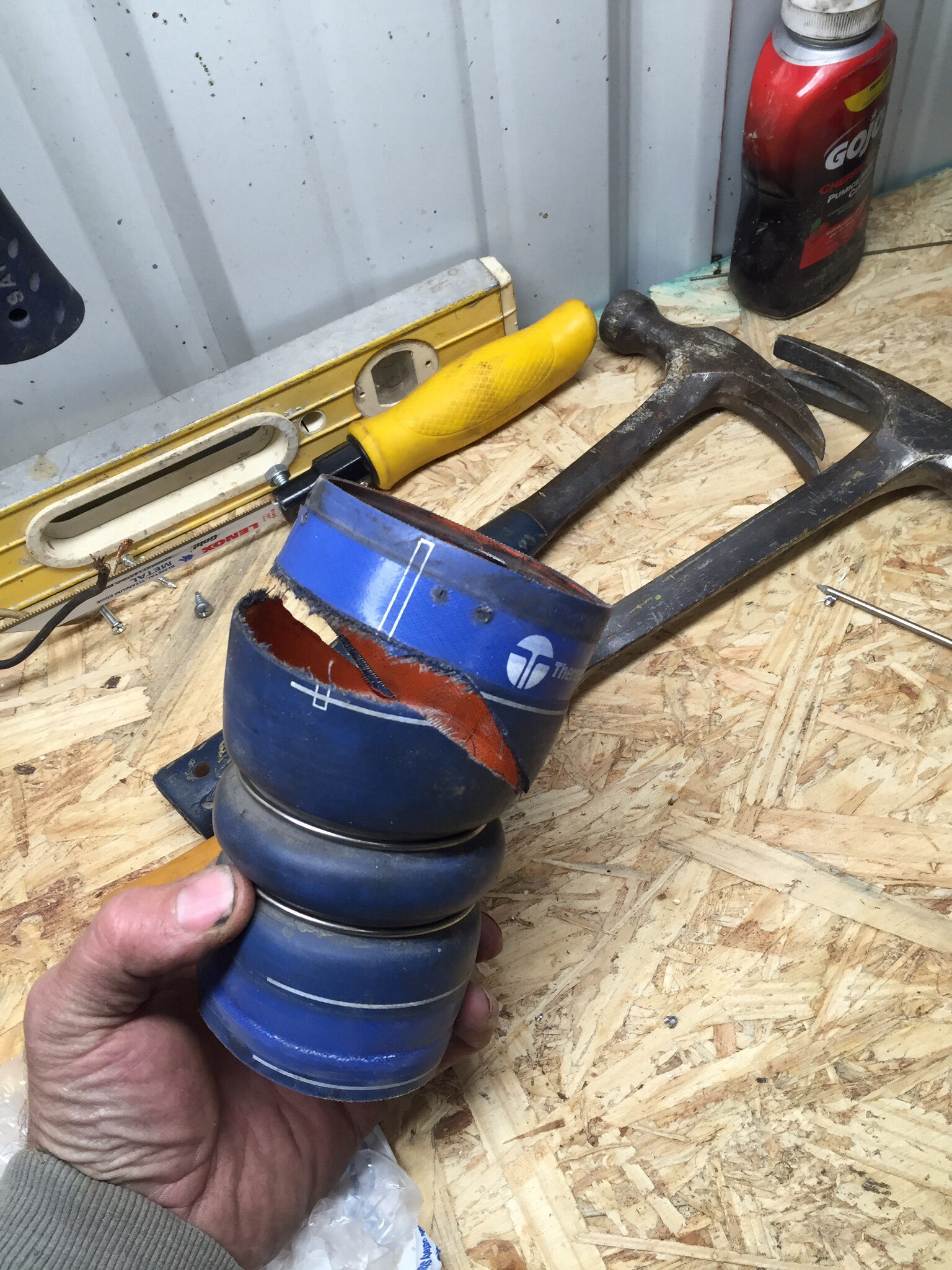

I popped the upper boot off and it broke the plastic mounting tabs for the intercooler. I'm looking at replacement intercoolers. There seem to be quite a few that are high quality all-aluminum but they are pricey.
Any experience with this CSF intercooler? It's listed as with aluminum tanks.
http://www.ebay.com/itm/400974228845
