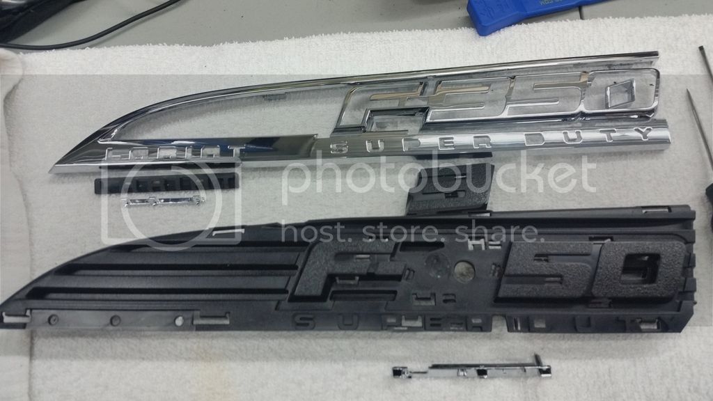

Get yourself an assortment of small tools

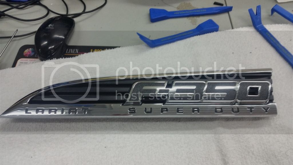

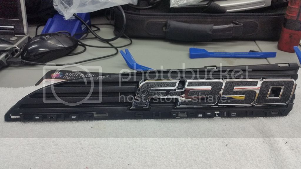

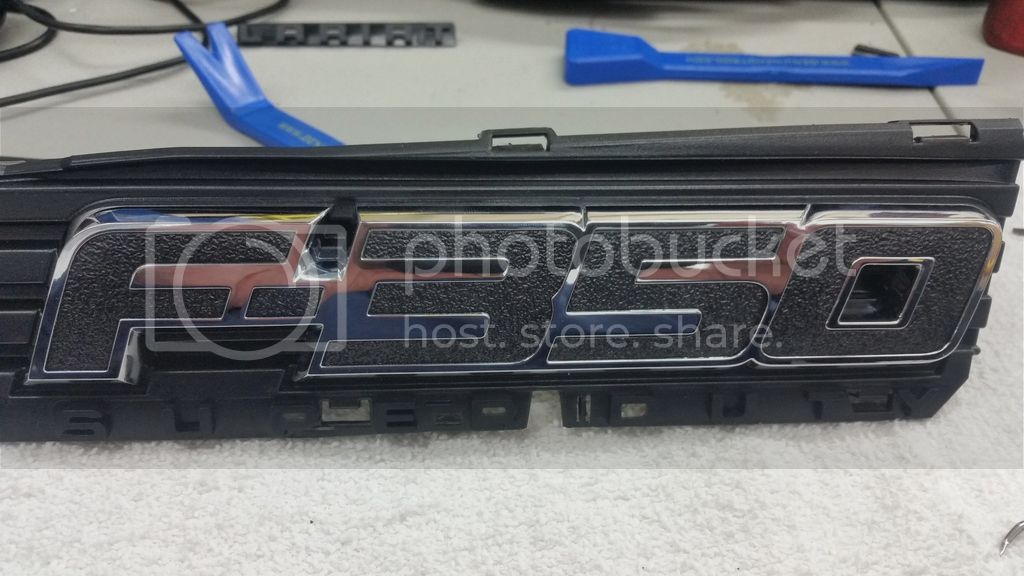

Stock emblem

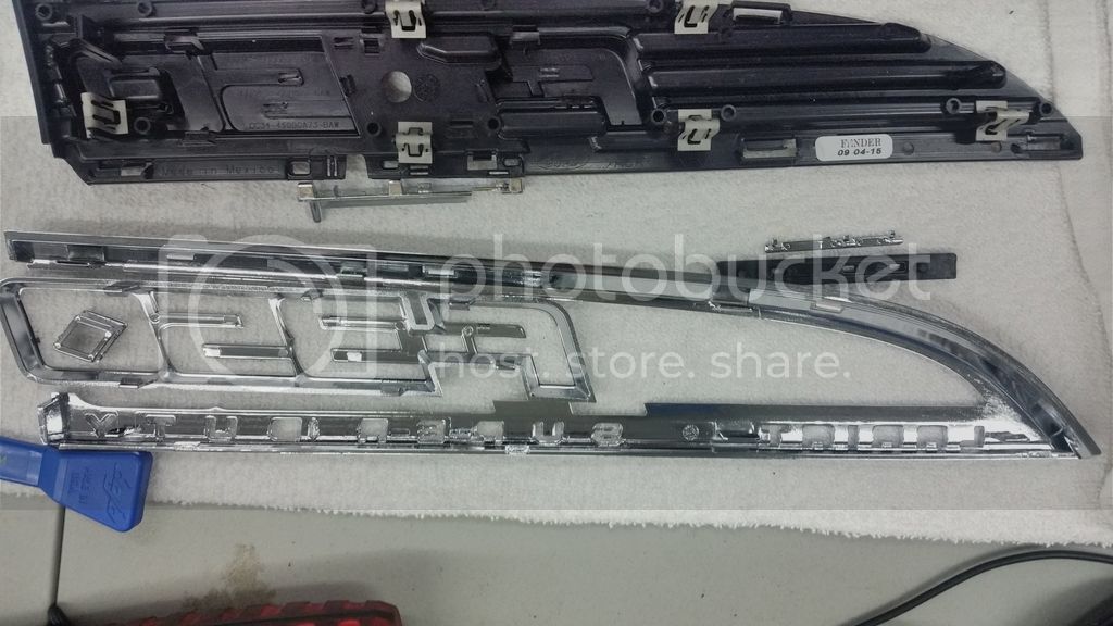

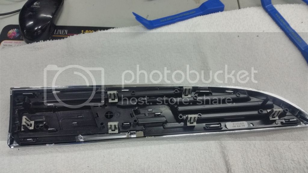

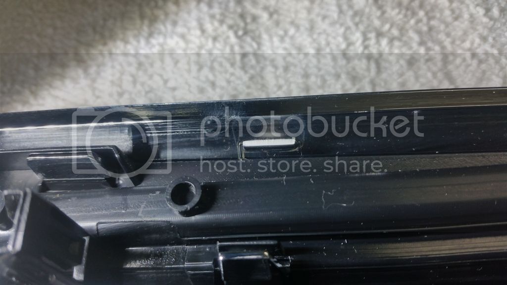

There are basically two major parts to the emblems....chrome border and the F250/F350.
First up, the chrome border. I started with the border. The border is held on with a plastic "hooks". Use a suitable tool to gently pry the plastic tab away from the hook.

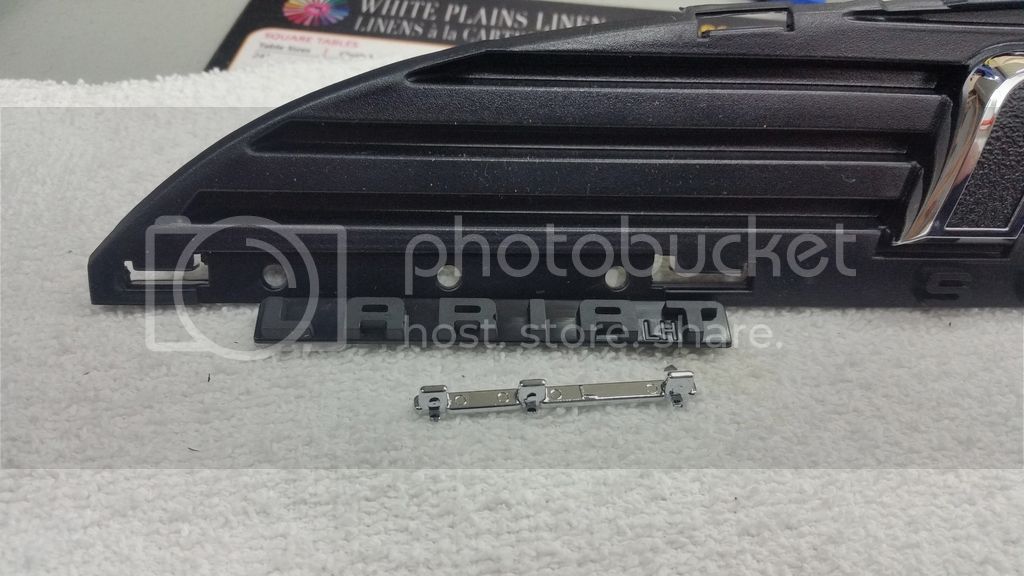

Next up is the "Lariat" (if equipped)
The Lariat falls out once the border is removed. The chrome center between the letters the two "A"s and "R" needs to be gently pried out.

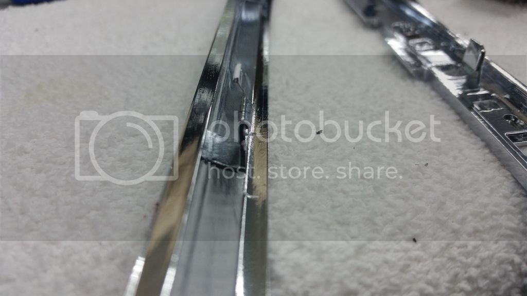

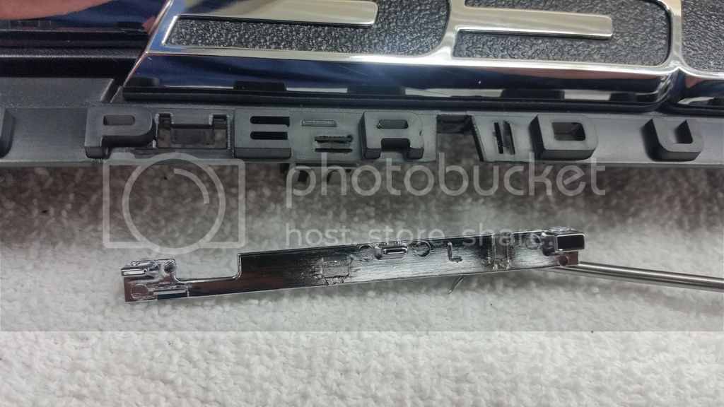

Next is the chrome in the "Super Duty"
Basically the chrome center is the same as the "Lariat" but with a twist. Between the "E" and "R" of "Super" is a minature plastic hook. You to gently seperate the plastic strip away from the chrome hook. You might be able to cut the little strip and glue the chrome to black plastic but I do NOT know.

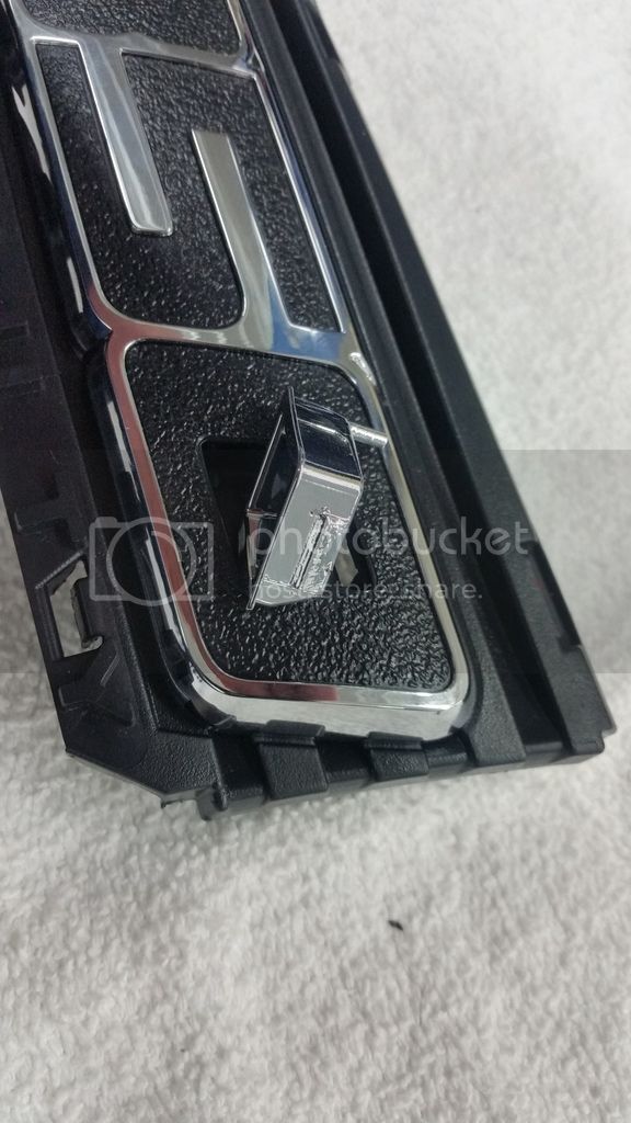

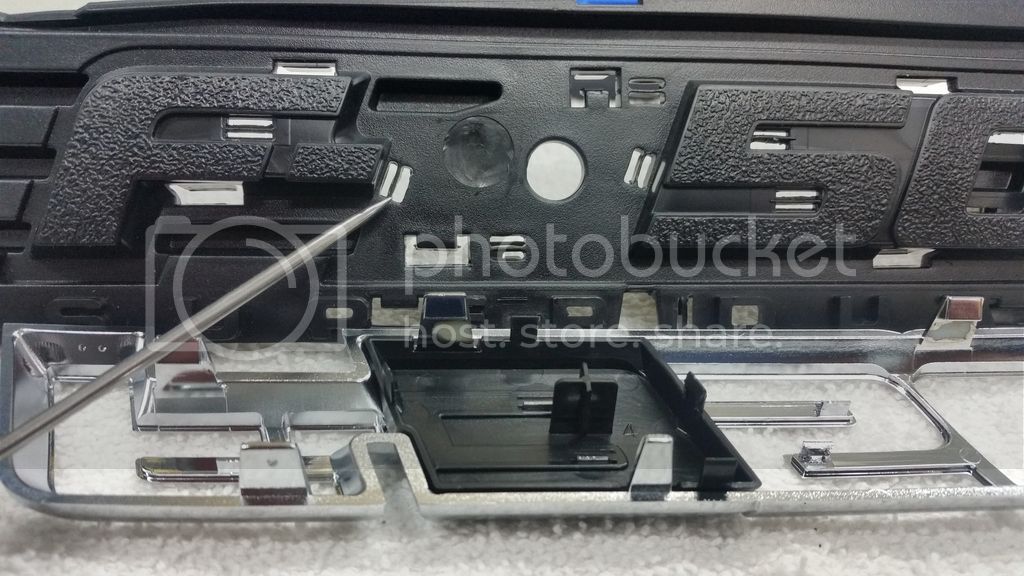

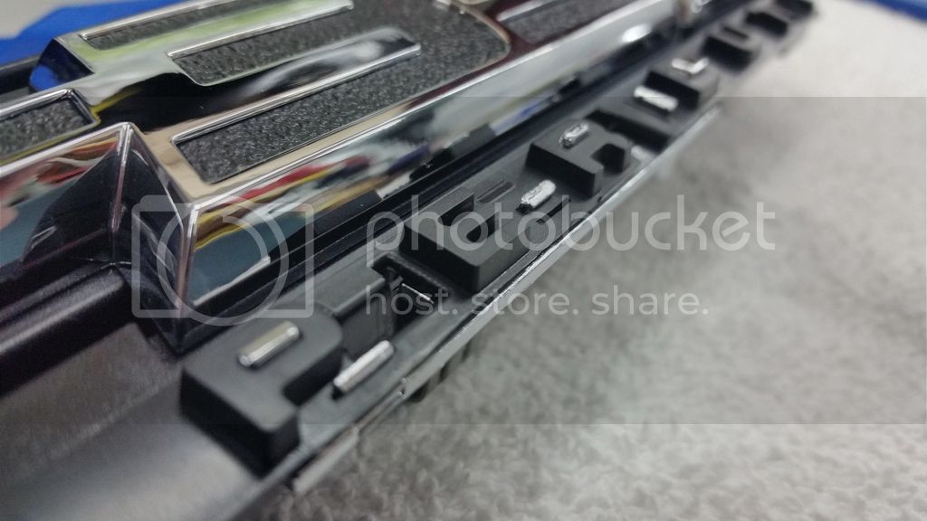

Next up is the "F350". This requires the most patience. I can't stress enough..... you need to take your time here. You can very easily break the "fingers" on the "F", "3" and "5". The black plastic back of the "3" comes out. You have to work both the large and small hooks together. I can't stress enough, don't push to hard. If you push hard and the the hook pops free, you will break the chrome.
The "0" pops out from the back side.
