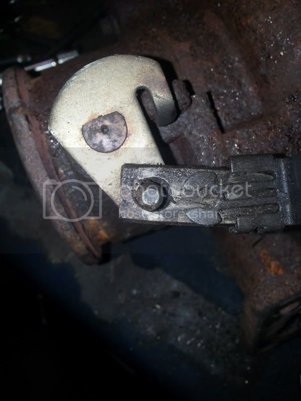

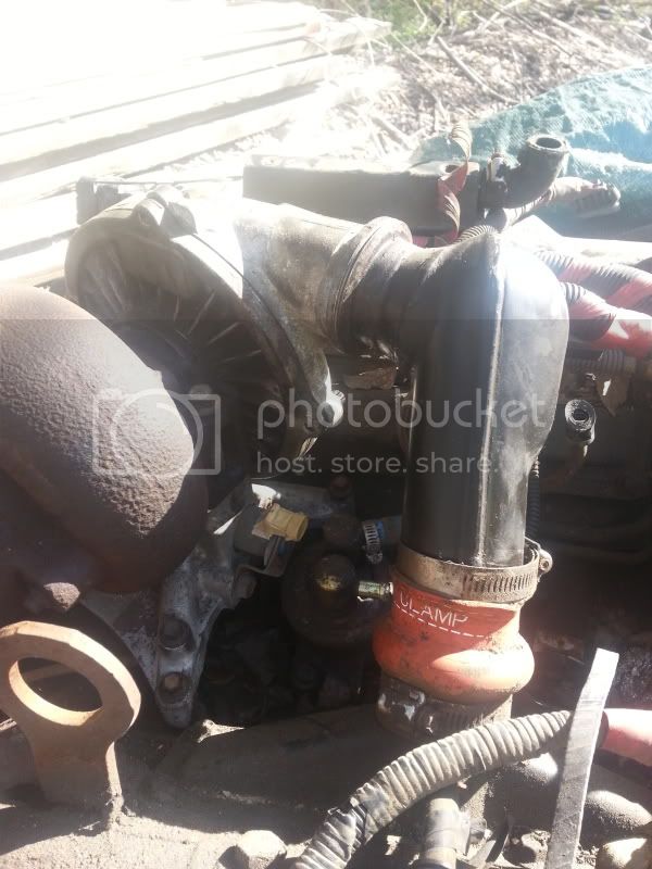

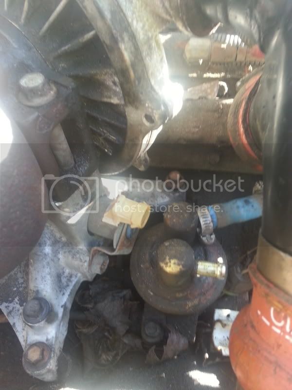

turbo bolted in and spider installed
e99 ebpv rod .. u cant see its a little big but the clip holds it fine
even tried it with the obs ebpv rod ... it also works
only issue if any is its a bit tight to the fuel pump
but nothing hits

Its not in my daily driver I built it for my new engine but it should perform just like stock because it is the same size

Turno removal in 10-30 min rather than 2-4 hrs
