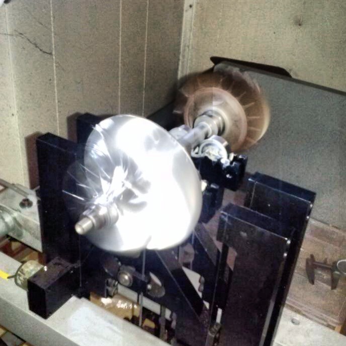

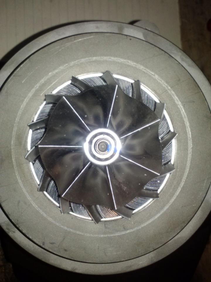

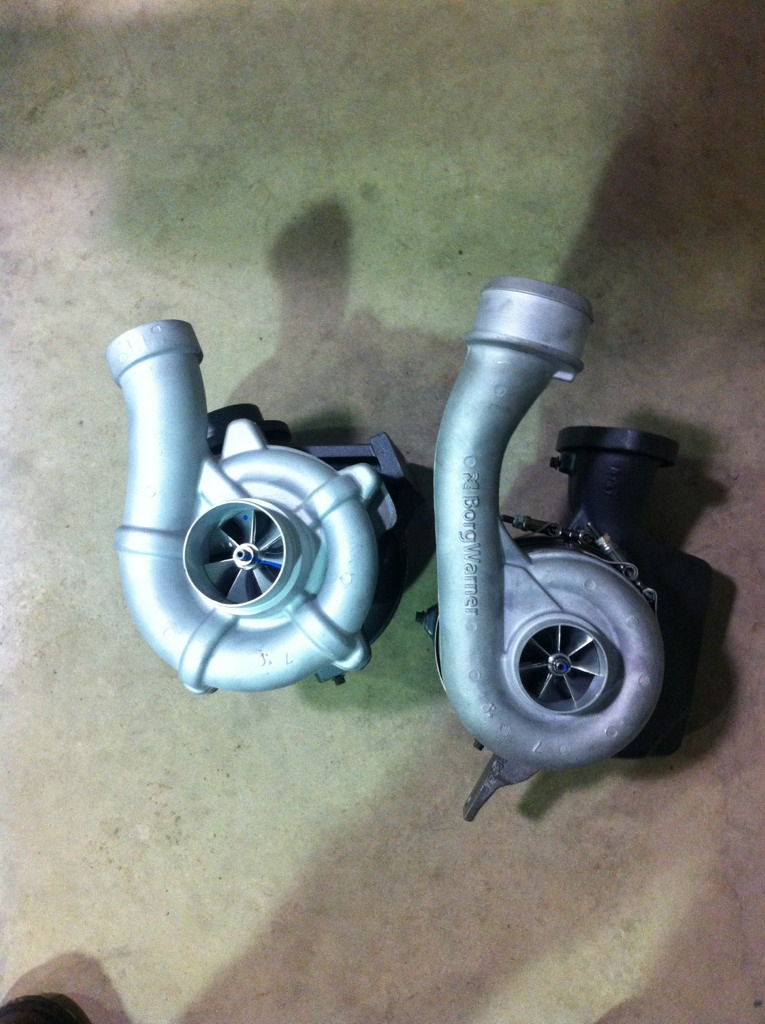

well, I was originally planning on bigger turbos. but we decided to do several custom sets that we are going to offer.. so I am going to be testing them all, starting with the smallest. rykan and i been talking about these setups since around this time last year, just waiting till my truck was available to build.
so here's the first set.. 71/59 full billet with clipped exhaust wheel, everything was assembly balanced, with upgraded thrust bearings.. I'll be up at innovative getting some numbers on these soon. we have a 73mm Atmo in the works to throw on with the 59mm shortly after I get results.. then one setup larger in the near future..
