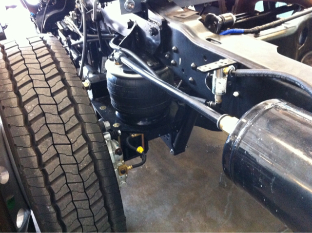

This is a '15 F450 that I did. Rides very nice. When loaded the rear is 1" lower than unloaded ride height.

Kelderman's aren't really that expensive anymore, they're about the price of a Carli/Icon mid-range lift kit, if not less.
As far as maintenance, unless a bag ruptures, and you have a good water/oil separator on your air system, you shouldn't have any more problems than you would with a standard setup.
Kelderman setup's remove the need for traction bars, due to the fact the system is pretty much traction bars on air bags.
