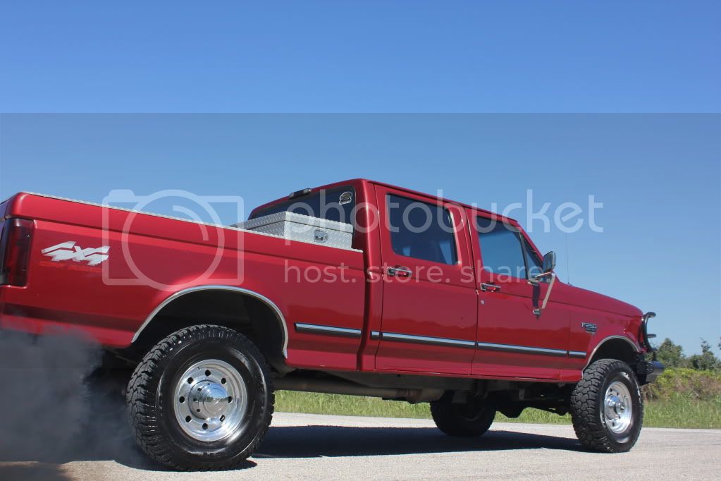

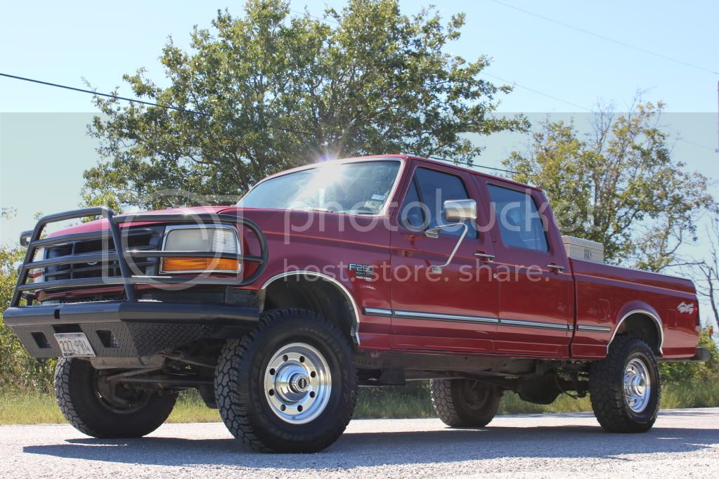

Thats the way to go. I know that i enjoyed mine, but just like everyone else says....it wont be enough lol. I wanted to go bigger like a year into mine haha. Not trying to get off topic of the thread but here is pictures of my old truck with stage 160cc injectors.
