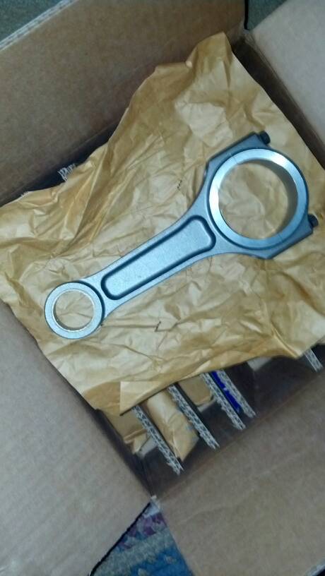

The whole idea is cost vs value.... use a forged rod engine, break it, then decide... build or just toss another forged rod engine in. If you're going to BUILD an engine designed to MAKE power... factory forged rods are not even an option. I use hypermax, manley, carrillo or crowers. I think carrillo were the cheapest last time I checked a couple months ago.
