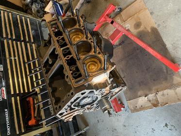

Well I got a bunch of parts and went a different direction from when I first started this idea. Got everything from Kill Devil Diesel and went with Wagler rods, KDD .020 coated pistons, new KDD heads and just going to keep stock power level for now that I have a baby on the way!
