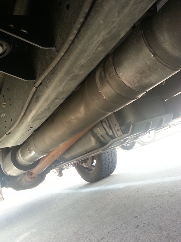

BK39
Aug 5, 2011
1,058
Texas
No, that back there is my flo-pro muffler.
That first band clamp on the right side of the pic is where the resonator starts, it's 30" long. After the resonator there is another band clamp(chrome shiny clamp) connecting a small 16" or 18" pipe, then the muffler.
Circled the resonator in green.

Ok gotcha, I'm on my phone do it's kinda hrs to tell. Thank you
