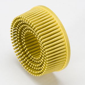

Scrap off the big chunks then use this
Whatever you do, do NOT use the Roloc Scotch Brite pads around an open motor unless you wanna rebuild it.

The grit from the wheels gets everywhere.
